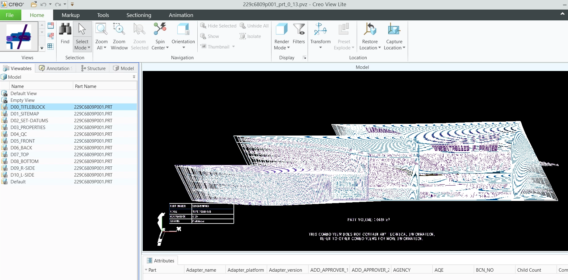

When opening views in a pvz file in Creoview 9.1 , when i click on one of the viewables, (IE D01, D02...) It shades the image.  I am not sure what setting is causing this.  I attached an image on this thread
I guess the problem is caused by graphic card driver.
  • what graphic card is installed in your computer ?
  • what  graphic card driver version is installed ?
Intel UHD Graphics 620. driver version 26.20.100.6860.
