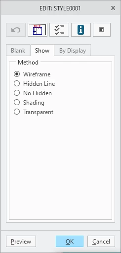

Hi everyone,
I have part A and part B in an assembly.
Is it possible to have part A displayed as shading with edges while part B displayed as shading only?
I have tried combined stated, played with view manager, but so far can't do it.
Your help much appreciated.
Cheers
Sandy
Best answer by MartinHanak
@Sandy1 wrote:
Hi everyone,
Cheers
Sandy
I think such functionality is not implemented. See following dialog box - it does not contain Shading with edges option.
Sandy11-VisitorAuthor
October 11, 2021
Thank you Martin. I guess this feature is not there in CREO.
