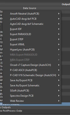

Hi, I have to import a CAD file from ALTIUM software.
The CAD file is an electronic board exported by the software ALTIUM in a 25 MB .step (or 20 MB .x_t).
ALTIUM can export the files format in the picture below.
When I import this two types of files, they opens in a long time.
How can I reduce the time of uploading of that types of CAD models?

A couple of options:
The board files can have many geometric entities and components in them, this is why it takes a long time to import. Use the filtering in Altium to not include irrelevant items in the export. Try excluding all via holes in the PCB as a start.
Use the IDF interface rather than Parasolid option. This supports exporting the PCB and components in separate files. You will need to manage the ECAD and MCAD environment for this option to work correctly but it is much more streamlined than STEP or Parasolid.
