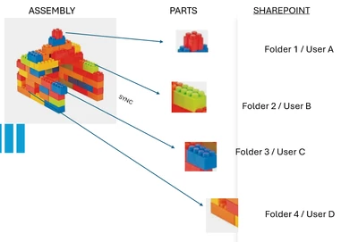

SHAREPOINT multiple folders part access for Assembly
We are actively moving to SharePoint data storage. Can assembly be organized with Parts in multiple folders / Multiple access users working on different parts of an ASSEMBLY. Assembly Regenerate should update the assembly with latest in SharePoint folders.

If you set your search paths properly, it should work.
You will need to be careful of the same file name existing in multiple folders as the system will load the first one it finds.

I am not using it for a complex ASM. Very simple one step drop ASM.
How to set search path?
Folder1 Folder2 Folder3 ....
No complex parts, No sub assemblies.
This is exciting if I can set different folders to look for different parts (Provided Part number remains strictly RIGID)
