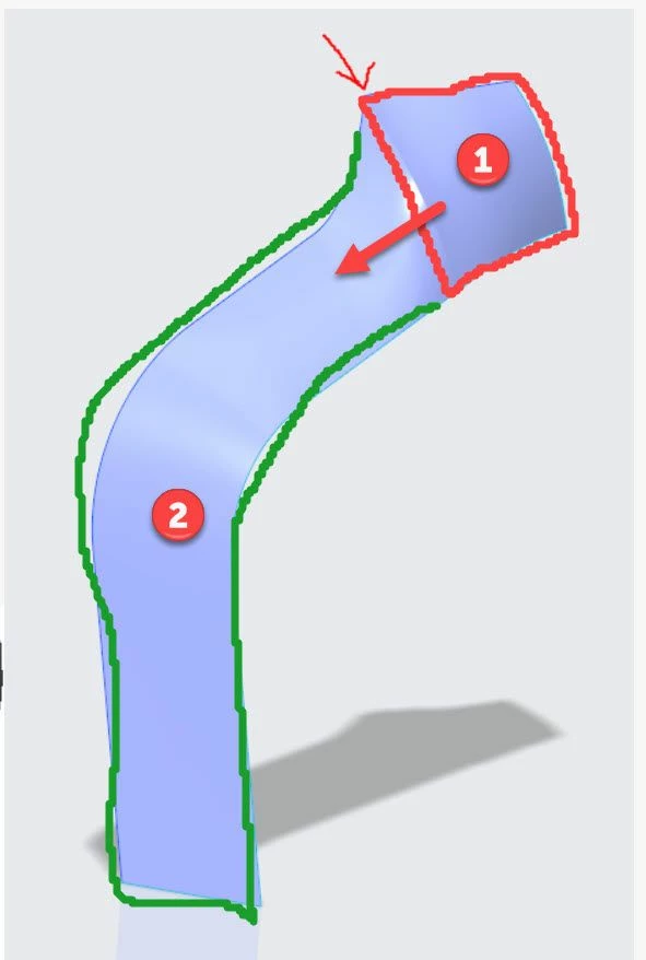

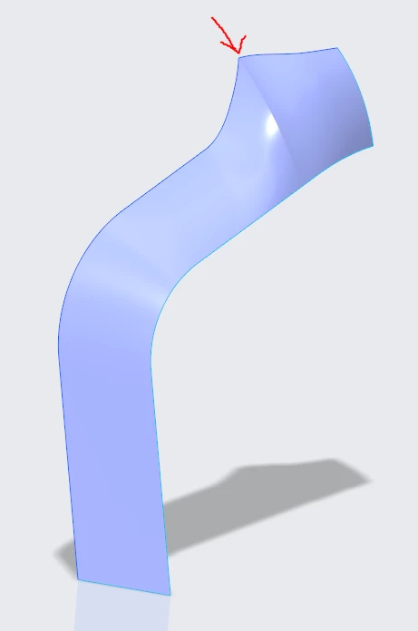

I am trying to get a curvature like the photo attached, however it ended up as a sharp edge, attached my part file, I don't know what my mistake is.

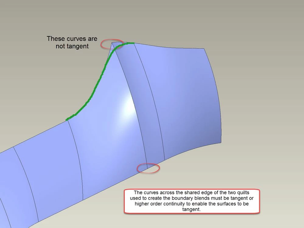

All of the underlying curves must have continuity equal to or greater than the surface connection you desire. Your construction geometry does not satisfy this requirement. If you can use a curve that is G1 or higher across the boundary (see green curve in pic) it will enable a tangent connection of the surfaces.
Refer to this link for more details about continuity and applications to surface modeling.
Continuity in surfacing

I can not open the file in Creo 4 but it would appear that your underlying curves do not support tangency (or higher continuity) across the boundary. The curves defining the surface edges must have continuity equal to or greater than the desired surface connection continuity. The sharp corner you point to is likely the issue.
If subdivide the surface shown into 2 or more features you would have more control over the connections between patches in the quilt. Are you using ISDX (style features) or Creo surface to build this?
See the pic. Build 2 4 sided boundary blends as shown and use the common edge of BB1 (make sure to select the edge of the surface and not the curve) as one side of the second BB. You can then try to set the tangency of the common edge in the second BB.G1 cont.jpg

I tried changing it to tangent on the 2nd bb but it will not generate, attached a .stp file instead.
I am guessing because the curve at the 1st BB is too steep while the 2nd BB is not. I am unsure how to make splines that correspond to the 1st BBs curve profilie so that it will allow the smooth curvature.

The curves defining the top have no tangency.
