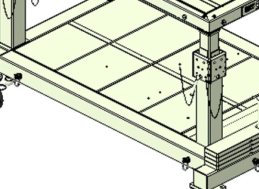

Curious how I can get my tangent edges to display as such in assembly view:

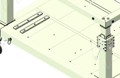

Currently, my model is displaying like this instead:
And I need to match the first image view style for a presentation I'm updating. Any idea? Been messing with settings and configuration values for over an hour trying to figure it out.

It would appear that the lower image was rendered with the tangent edges set to dimmed. Try setting the tangent edges to solid in the options UI and then shade with edges.

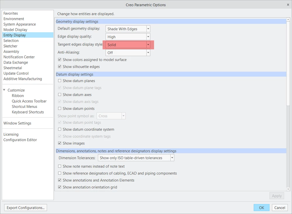

I have Tangent Edge display to Solid and I'm still not achieving what I'm looking for. Not sure if there is something else that is overriding this?
