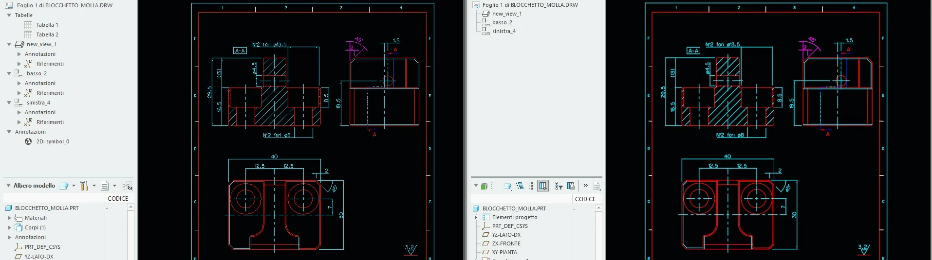

I have an issue with the visualization of the dimensions in the drawings in Creo 11.0.2.0.
The dimensions are not sharp like not perfectly in focus.
I have attached one screenshot with the same drawing opened with Creo 7.0.2.0 (left) and Creo 11.0.2.0 (right). There is a big difference for me.
I tried with another monitor with higher resolution and the result is the same.
Any one can help me?

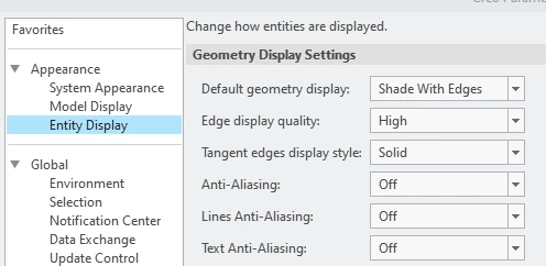

Looks to me like you have anti-Aliasing turned up:

Thank you, you are right.
