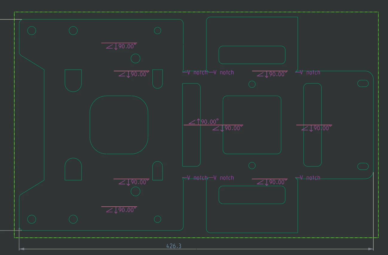

how can I add the default bend radius in the bend notes? I want to add the default sheet metal bend radius at all notes and for all the feature drawing that I’ll do.
Maybe I have do modify a config.pro command?
Thank you!

Creo 12 help center: About Bend Notes
File > Options > Options > Core > Sheetmetal > Bend not element order:  Add “R&inner_radius” to the setting.
Or manually add “smt_bend_notes_order &type&direction&angle R&inner_radius” to your config and regenerate the model.
Jul 24, 2026 2:46 PM UTC
Thank you kdirth, it works well!
I tried the second mode and it solved the problem.
