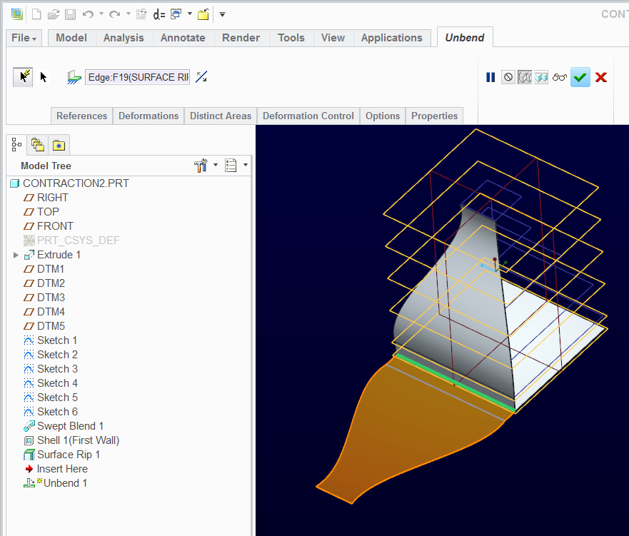

I'm trying to get sheetmetal drawing from part created with swept blend feature.
The trouble I'm having is to use edge rip tool to split the curve. The part I would like to make is attached here.
I have tried a simpler pyramid shape (square top square bot) and was successful in making the sheetmetal.
Thanks in advance for your help.

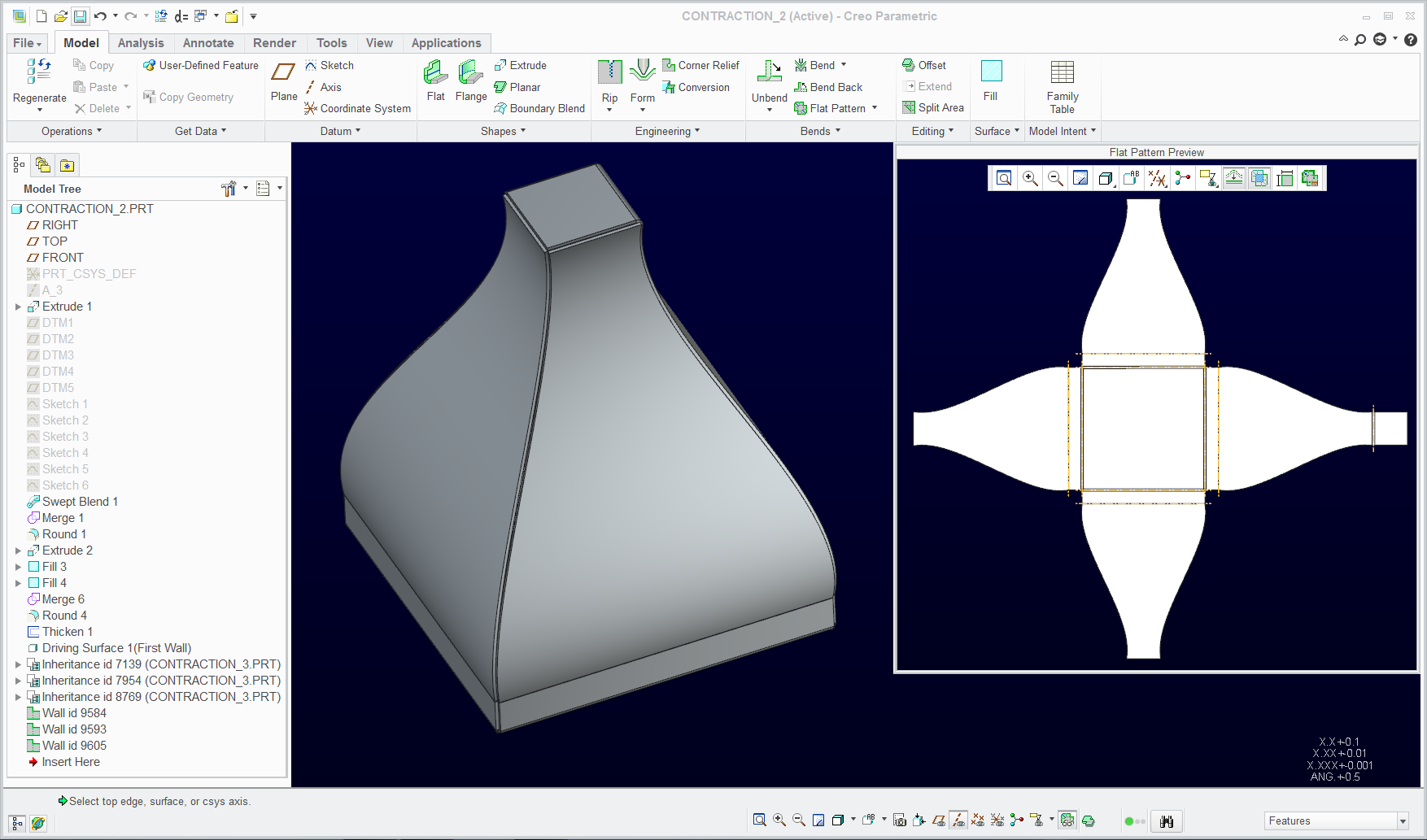

This was definitely a lot more work than I thought it would be, but it is possible.
Creo 2.0 attached
I used the merge from an assembly level to get the other 3 walls. I you open the assembly 1st, then open the contraction_2.prt.
However I don't know how you are going to form this in the way I modeled it. I could see this more like a clamshell design. Weld two edges along the bottom and 2 edges along the top.

The only thing I could do was to do a surface rip on 3 of the faces (6 surfaces). After that, I was able to do an Unbend feature. I removed the small radius ont he top and removed the top surface in the shell command.

Funny shapes in sheetmetal are not easy to deal with. If I wanted a flat pattern of something close to this, I would probably make this with surfaces and use Flatten Quilt to get an fairly accurate flat pattern for each wall.
You have to decide on how you want the edges to merge at the corners but this certainly possible within Creo.
Just because it -is- sheetmetal, doesn't mean you need the sheetmetal module to come up with the right geometry. I have done ribs that have a curved profile in two direction in core Creo where sheetmetal simply cannot do that. If you want a close representation to allow for bend allowances, when you thicken the quilt, offset it to both directions.
