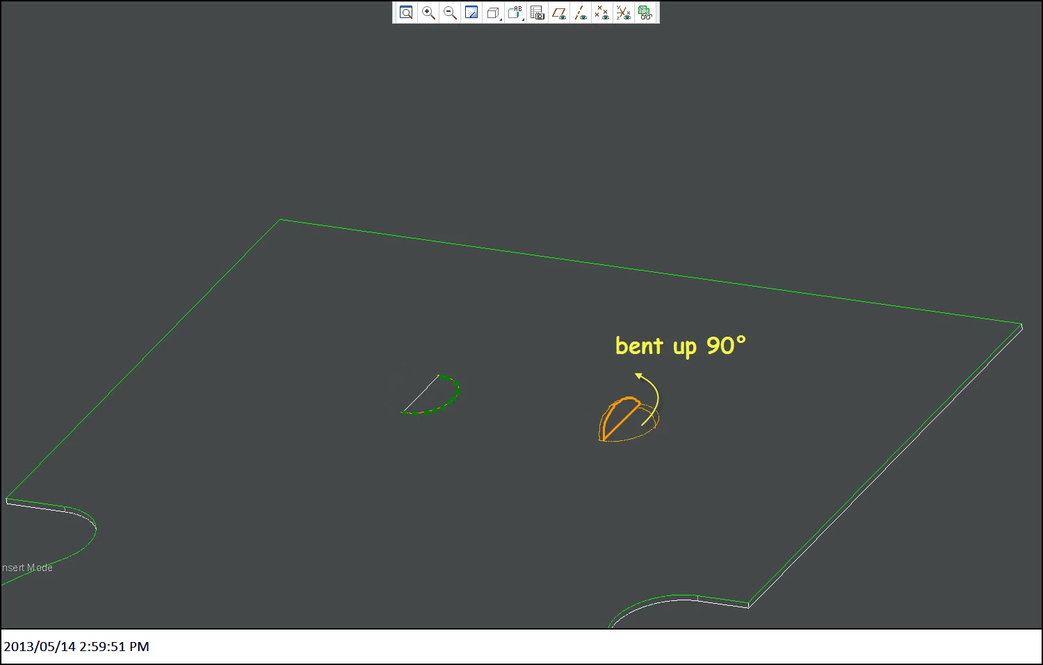

If you see the attached jpeg, you can see what I want to do (assuming my Snagit skills are good enough).
I want to pierce a semi-circle and bend it up 90 degrees along the axis of the semi-circle. Seems easy, doesn't it? I start with a planar wall, no openings. I would have though some kind of rop to start with, but I can't do a sketched rip without going completely to the edge of the model, and I only want to rip a half circle, not the whole thing.
I also don't want to remove material if I can help it. Is there a simplae way to do this without cutting an opening then adding a wall? Even tha doesn't work if I use a flat wall - it won't rotate it up, only down, and then only about 10 degrees. This is Creo 2.0.

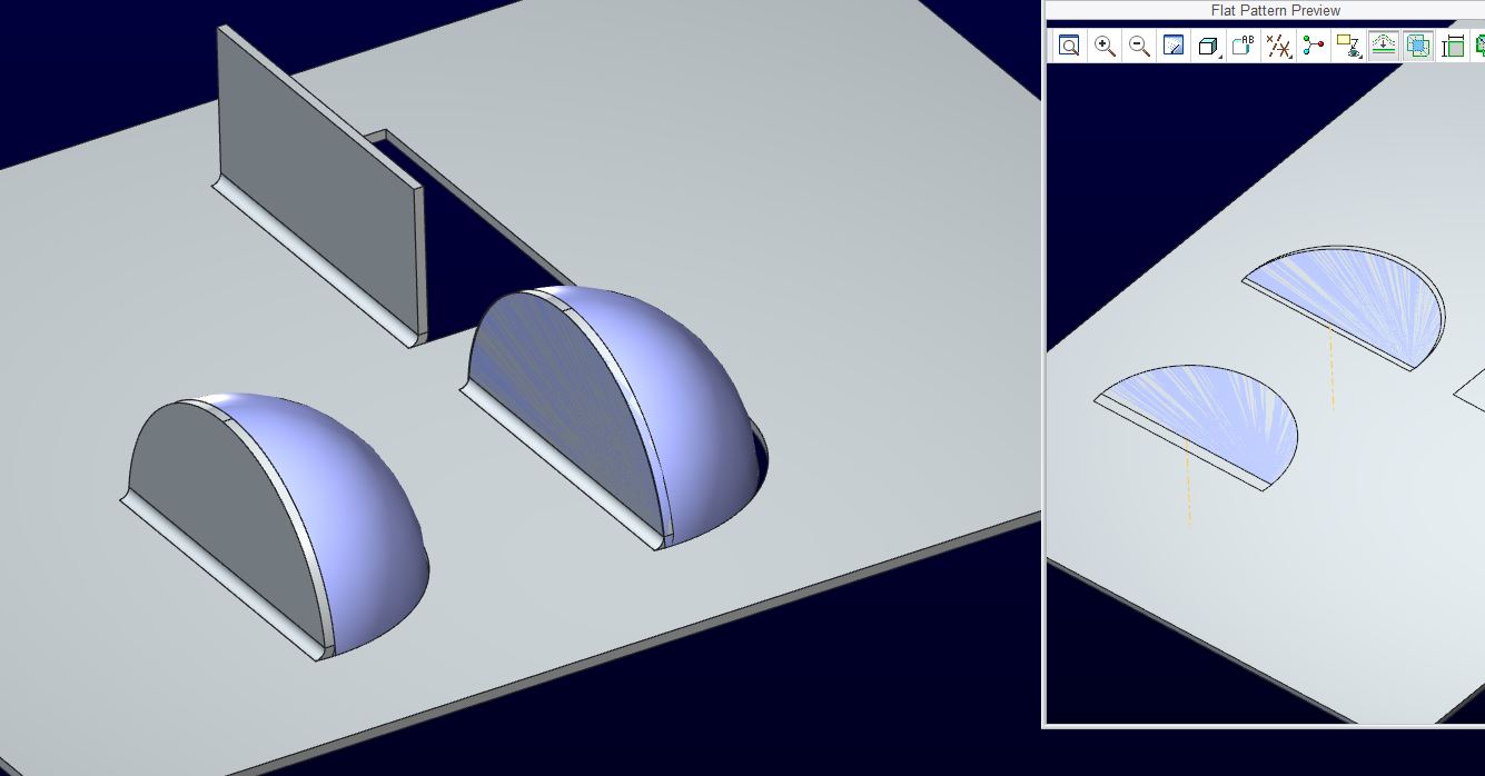

This is what we have forms for. Of course, it doesn't calculate the actual material available to determine the appropriate height of the folded semicircle.
So if you create the form (I like the quilt forms for on the fly forms), a quarter sphere, you can have the feature remove the spherical part of the form leaving only the semicircle wall.
To test the actual height of the feature, you can do this with a normal wall and determine the unfold length. You can use this information in creating the form.
Once you flat pattern the part, the flatten form feature will show where the form was applied.
(The form will also need a flat section for the material thickness, but you get the idea, right?)

May 15, 2013
Thanks Antonius. That looks like just what Iwas trying to do. I did try the quilt form before, but couln't get it to work. I'm not sure what I was doing wrong, but you seem to have got it exactly right.
