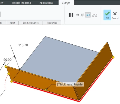

I am using Creo 7.0.8.0. In earlier versions of Creo, I remember being able to bend 4 walls of a simple sheetmetal box in one feature by control-clicking the 4 edges of the first planar feature. I can't seem to do this anymore. When I hold the ctrl key, there is no option to select additional edges. I have to create 4 separate flat-bend features to create a box. Am I missing something here? Thank you.

Flange feature, then "details", then select rule based, complete loop, you'll have one of the edges and the surface with all 4 sides

When adding a bend to multiple surfaces, make sure that the surfaces are coplanar and that the driving and offset surfaces match. In addition, the normal directions of the surfaces must be parallel and have the same start and end directions. The surfaces do not need to be adjacent.

There is only one surface, so all this criteria is met. I started with one planar surface and I want to make a wall on each edge of that plane to construct a box.

The method shown by @StephenW is identical in Creo 7.0.12.0 to bend all four sides in a flange wall.

I am using Creo 7.   You have to use Flange and hold Shift to select adjacent edges or a surface to select a loop.

This method worked as well as Stephen's above. Thank you, kdirth.
