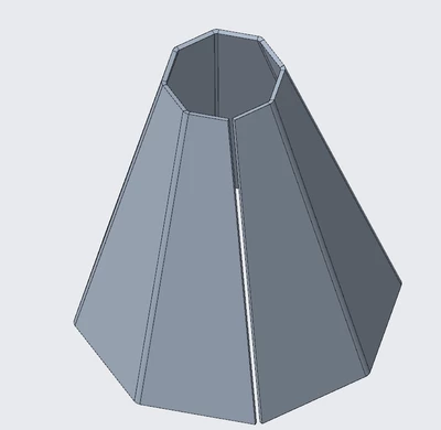

How about a Blend and a Surface Rip? Maybe fix the gap with an Extend feature or two. Five minutes to make a bent cone with any amount of bends that's available in the Sketcher Palette. The one below using an octagon.
Jun 14, 2024 11:48 AM UTC
That's how our template parts look like, but when we copy to an actual project, and the 'diameter' increases so the number of bend needs to be increased as well, the sketches require some delicate touches in order to adjust.
