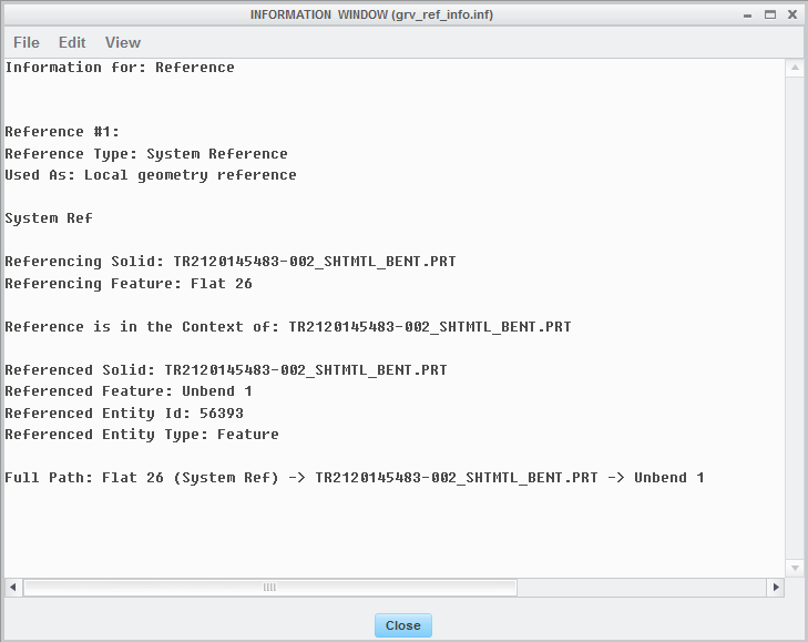

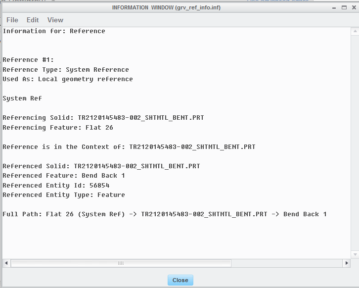

Detail on the two references, respectively:
StephenW
March 20, 2017
I'm thinking that when you create the first one, that determines the thickness. All the other parts reference the first one's thickness.
March 20, 2017
Good point.  Now that you mention it, the consecutive planars did already have their thickness set.  I think there's not even an option to override and specify it.  Interesting, considering there are no relationships listed in the reference viewer b/n the consecutive planars and anything in the first set since that's where the thickness is specified.  The relationships are b/n flats and the first bend and bend back
