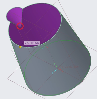

NOt being able to open a student version file, I would guess that your revolve did not fully intersect with the tank, leaving a small notch (see below).  Increase the revolve angle or decrease the diameter.

in my test model the problem is related to "red circle area".
thick 2.0
thick 6.0
thick 7.0 ... sharp tip
thick 7.1 ...failure

Thank you @kdirth and @MartinHanak for the quick replies. The issue was indeed the revolve angle being big enough, so it is curious that 210 degrees worked in the official PTC tutorial but not with the student versions of Creo. I increased the revolve angle to 300 degrees, and while I couldn't increase the shell thickness to 4.0 or above like Martin could, I was able to complete the rest of the playlist with some other errors.
