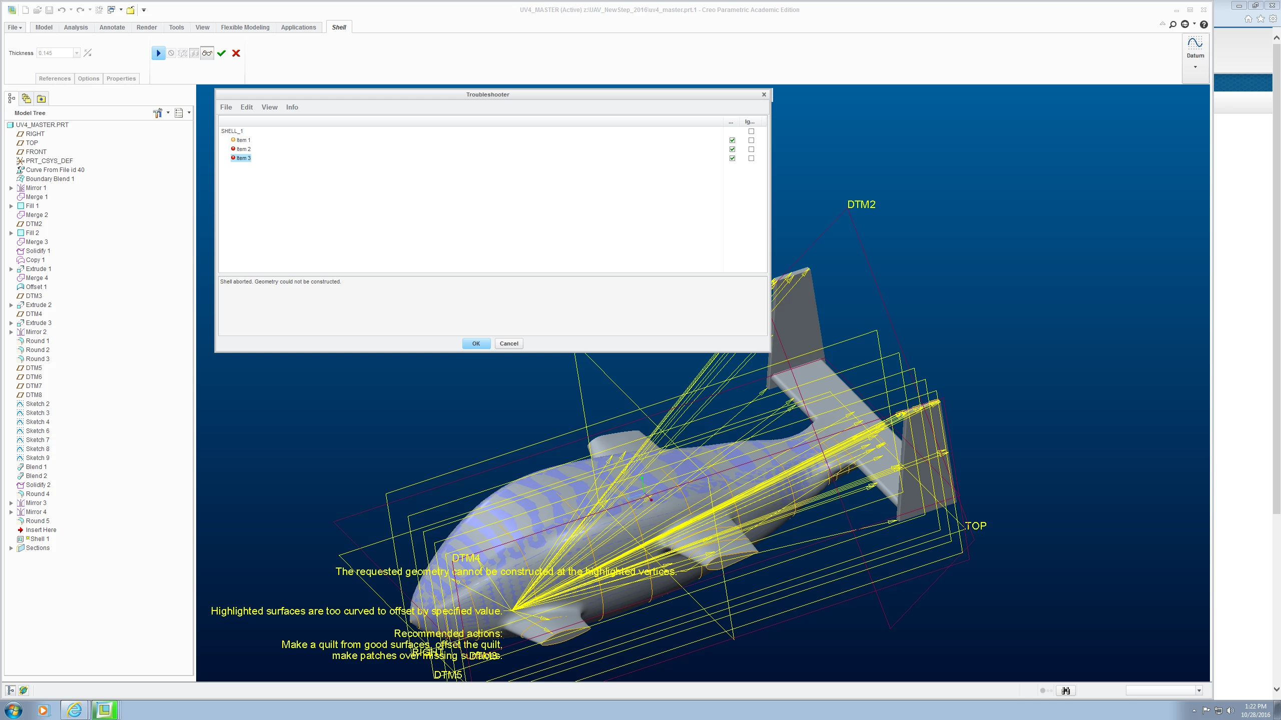

Good afternoon!! My team and I are currently in the design stage of our project. I am trying to shell a blend feature, see attachment above for details. We are trying to shell the outer face of the outer pylons (wings) on both sides of the object, but are having difficulty in doing so. Do you know of any solution beyond what is given in Creo to remedy and solve this problem? Thanks!!

It seems to me that model geometry is little bit complex for applying Shell feature. Please assign different color to surfaces you want to remove and publish new picture. Also tell us if you want to shell whole part -OR- its portion, only.
