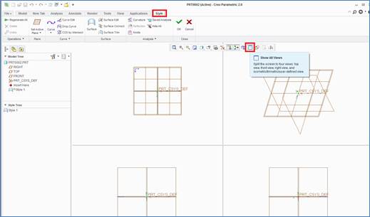

Why doesn't the "show all views" button work in my Creo 2.0 M020?
This is the option to have 4 standard views on the screen all at once.
For some reason, this is grayed out on my computer.
This use to be a standard feature. What am I missing here?

In Pro/E 18/19, 2000i I was able to put up multiple views on the screen while modeling (part and assembly). A feature I often used for presentations etc. This is the response I got from CS when I asked what happened to it:
A multiple view environment is available in Freeform Surfacing(Style feature), as against single view in standard Creo Parametric.
“Show All Views” command is activated and can be used in Style feature.
I responded requesting more information but from what I know, the Freeform Surfacing is an extension that cost extra.

Hi Antonius,
I have been working with Pro/E since version 17.0 and to be honest I do not remember "show all views" within Pro/E.
CDRS (or for a short time Pro/Design, the predecessor of style) has always had the four windows layout.
So possibly with its introduction into Pro/E in version 2001 they got rid of the redundancy...
December 7, 2012
Thanks Constantin. This is one feature I know for sure was there as it was very important for my work at the time. Your timeline may be correct. However, it is not redundant if it is run in an optional module.
CS concurs that it is only available by paying more money in Creo.
I need to pursue this further. It is very upsetting to loose capability. Sad enough that we are not getting anything meaningful for our maintenance dollars, but to actually migrate capability to optional extensions is ...well ...I will let you answer that one.
