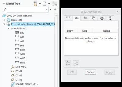

Can you show annotations / Gtol's in an External inheritance or External merge model?
Original model:
External merge model does not seem to carry the annotations along.
External inheritance model does carry the annotations along.

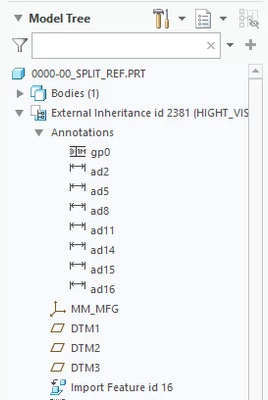

However, I am unable to show the annotations in the External inheritance model.
Any help would be greatly appreciated.

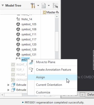

Best answer by trent_stone
From the annotation tab in the ribbon and in the correct combo view right click on the annotation and select assign.
7-Bedrock
October 1, 2020
7-Bedrock
October 1, 2020

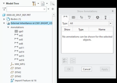

Ok. I assigned all my annotations to the default state. I am still unable to show them on the model.
