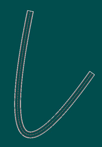

hello,
i have a problem: in a drawing of a sweep is it possible to show curves in drawing even if they are hidden? if i show hidden lines then i see the curve but if not i cannot see it.
thanks

Don't use hidden lines in views.  Get a set of rules-based layers, and use the layers.
cspinelli14-AlexandriteAuthor
August 24, 2015
‌yes, its only a view to show my problem.
if i i use NO HIDDEN i cannot see the curve right?
Patriot_1776
August 24, 2015
Sorry, brain fart.  Since it's the trajectory, yes you'll need to show hidden, but you should still put it on a layer that you turn off in only that view or any other where you need to show it.  For the rest, hide it.
