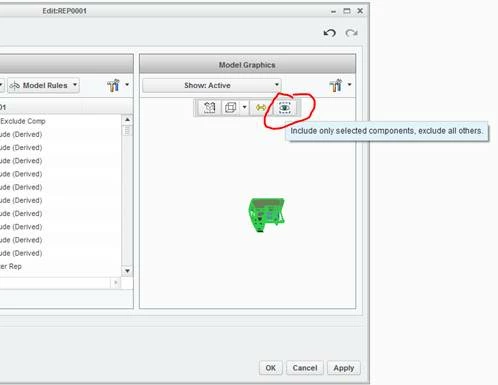

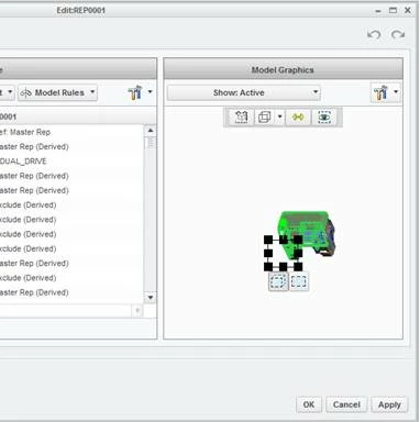

In Creo Parametric 2, you can do the following steps:
1) Copy simp Rep in View Manager and then edit the new rep
2) Use the preview window in the view manager to box select the items you want to keep or use other methods to select them. (first picture)
a. The additional selection tools built into the preview window are very impressive.
3) Then use the "isolate" icon. (second picture)
Note Make sure your config setting for searching server with preview is set to "no" if embedded with Windchill when you are in an environment where not all objects of the assembly reside in your workspace.
Also, Creo View has this functionality available using box selection and RMB functions directly in the graphics window...

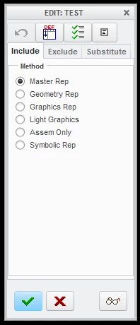

If you liked the way simplified reps used to work and you prefer it that way, you will need this line in your config.pro: new_wf5_simp_rep_ui no
Call me old school but I like to be able to just pick the models in the window or the model tree. I also find it very convenient to toggle the default between Include or Exclude. Sooo much easier (at least for me).

Jerry, we have some old school users here too. Note: one of the reasons users disliked the new UI was that they had to manually save the simplified rep when making changes using the model tree column functionality or RMB functions(ref picture). Sometime after build M070 build of Creo Parametric 2, the PTC programmers changed the functionality of the old UI to perform the same as the new UI in this regard. I’ve got a couple users that lost work on their definition of the simplified rep using the old UI and have convinced them to come to the other side!
95% of the time I’m using the model tree or simp rep column to manipulate the simplified rep so I’m not going to the UI.

And an update on the solution to isolate:
I did try the isolate function in the new user interface (haha, not so new anymore) and it’s awesome. I was able to box select an area that narrowed down the items show to just a few. Then I used the box selection again on the narrowed down selection again with a different spin on the model to narrow it down even further. I took an assembly of several thousand components and isolated 8-10 components I wanted to see in just a few seconds. I never had to activate the master rep which is the downside to the first method that was suggested which sometimes can be an issue on large assemblies.
I can use this functionality in my day to day usage when working on large assemblies to quickly created temporary simplified reps so I can add hardware to a component or check clearance in a specific spot.
