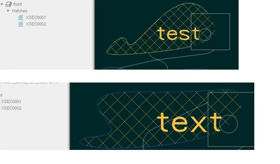

At least in Creo 4.0 drawing module, there seems to be an easy way to generate an x-hatch object which can "paint" model's surface or quilt with a pattern or solid-fill.  This is different from using drawing-sketch "Hatch/Fill" function you mentioned, in that the hatch does not use draft entities but it uses the model geometry directly.
1) In Layout mode, select in a drawing view the flat surface or quilt (might have to query-select) that you want to fill.
2) Then right-click, select "Hatch / Fill";
3) In the menu manager, select a "Fill" type of hatch pattern.
4) Select Done.
This technique creates in drawings x-hatches that are automatically updated when the model changes:
Quick test of opening the exported DXF file with Creo View shows the text filled correctly...
4) Select Done.

Thank you for replying to my post.  The technique you selected worked perfectly.  I really appreciate the help.
