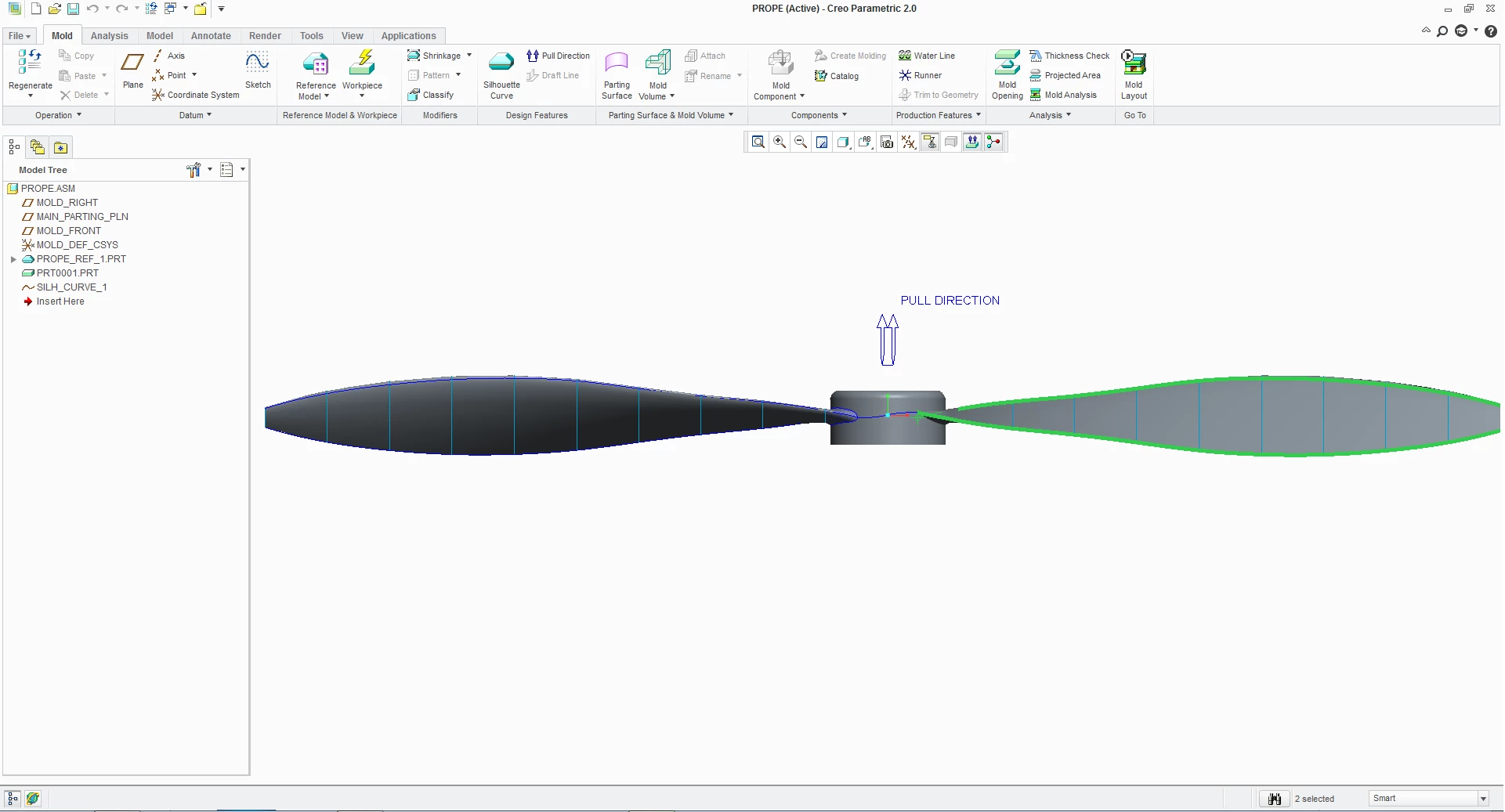

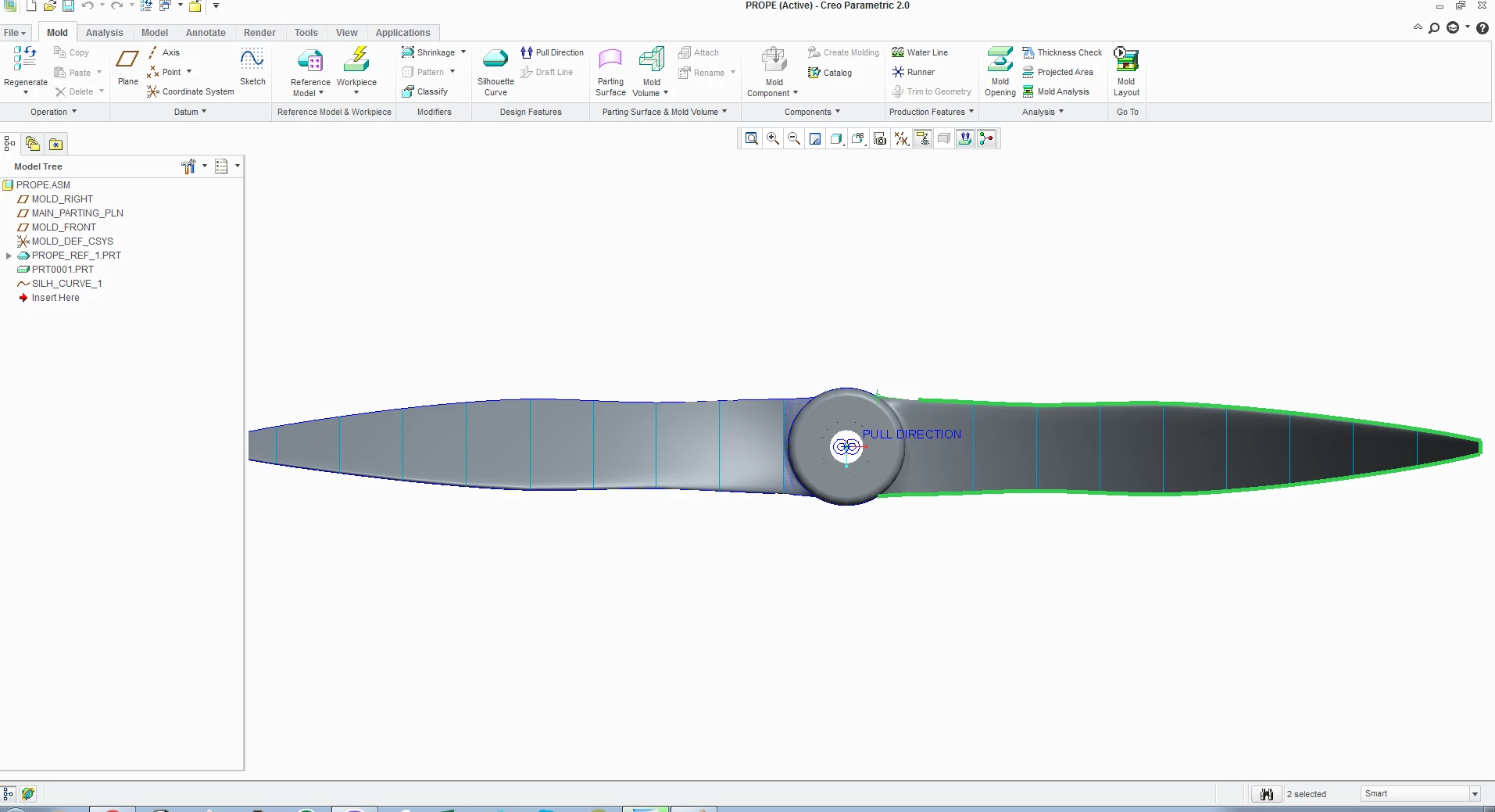

I design the propeller with Blend in the wing area and close to the hub the "reinforcement"  with style an then i solidify the surface.
The automated silhouette curve does not close all the part as sown in pics. I have search to find a tutorial or some solution but i was not able to fix my problem.
There is someone to known how i fix this ?
There is a way to drawing my own silhouette curve ?
Thank in advance

Are all of the surfaces selected for the silhouette curve?

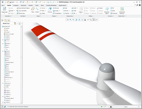

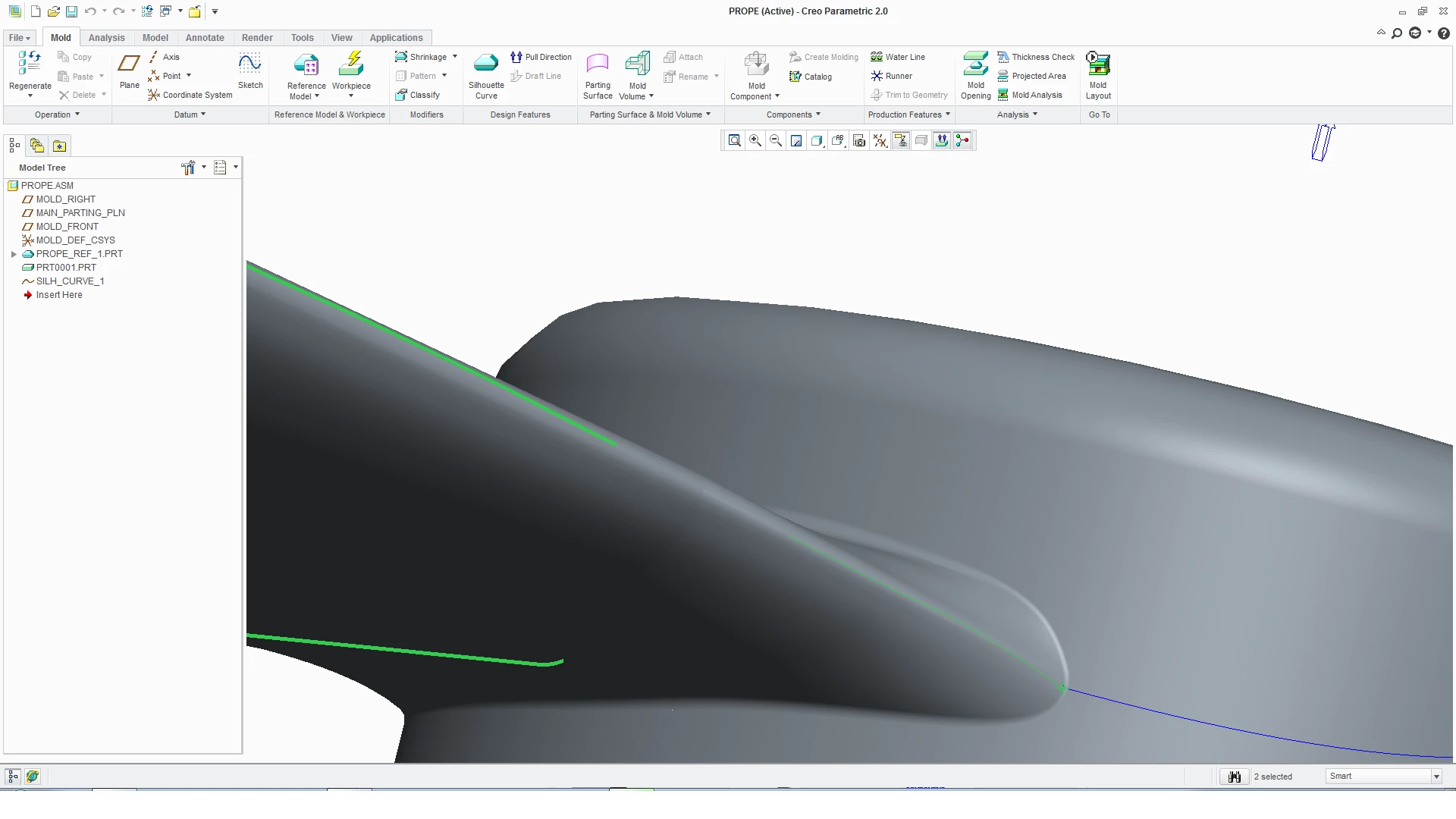

no only those regional to the shape, In the propeller_3 photo sows the the silhouette curve.
I attach to more photos with all curves and those i exclude. The  dark blue curve witch connect the tow blade in the hub region i created with style

Can you attach the model so that we can look at it?
