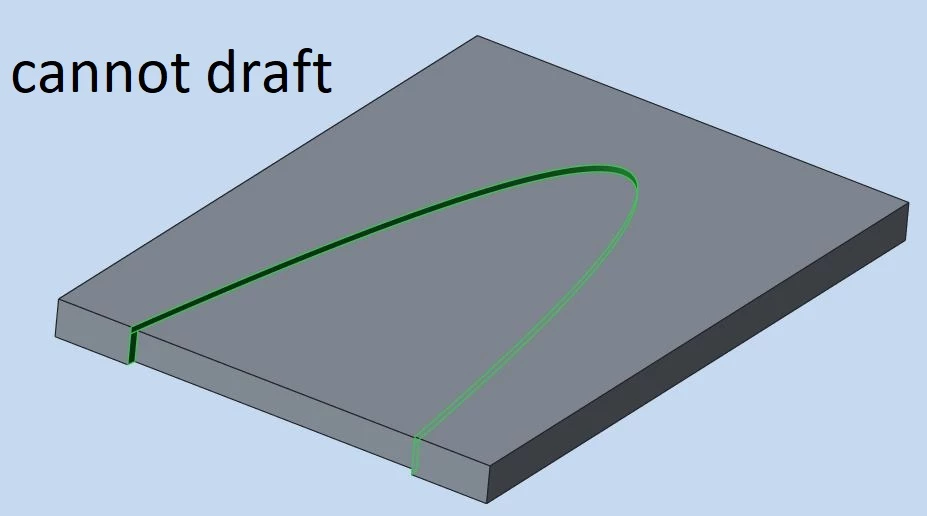

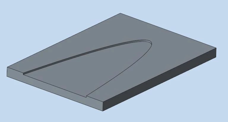

I'm trying to add draft to an inner wall of the part and I'm having some trouble. I'm using the draft feature, but I'm not sure why creo doesn't want to create a draft in this location.
Can anyone help why?
Thank you in advance.

Like this
Follow that with your extrude that cuts in a little and is .1 less depth.
Then you can draft.

Try changing the accuracy of model. Can you share the part?

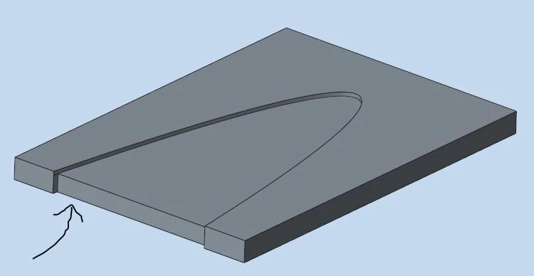

Here's the model. what do you mean by accuracy of model?
another weird part about this is the line that separates the two extrusions I use to cut the main box. I cannot seem to make this a seemless transition.

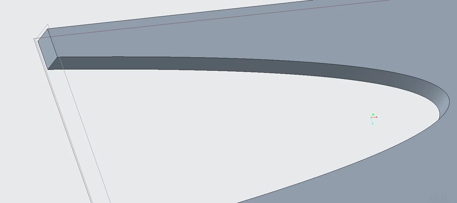

No doubt, @pimm gave a good solution, another one can be as in attached part.

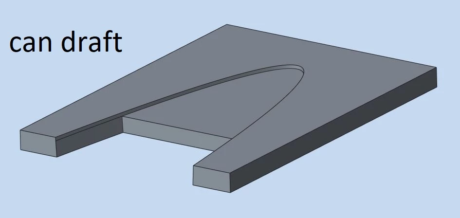

The thing that stands out to me is that there is a seam when you do your 2nd extrude in the 3rd jpeg.
If you could make the outer extrude in 1 operation which would contour inside in the middle.  Then the 2nd extrude would set inside somewhat and at the shallower depth.  That should not leave a seam.  That should allow you to draft the inside sidewall.

How would you make that extrusion in 1 operation?

pimm15-MoonstoneAnswer
Apr 2, 2018 7:38 PM UTC
Like this
Then you can draft.
