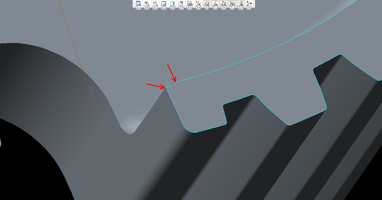

Hi, I'm trying to sweep a Powdered Metal Chamfer around the the profile of an involute gear tooth profile. I have tried several times with no luck. It either fails to generate or gives me an error that says something about changing the part accuracy. tried to mess with the accuracy and just made other features fail.
1. I'm not familiar with what the accuracy pertaining to creo is/does
2. Any help or rules of thumb with sweeps and this particular sweep would be greatly appreciated
attached is the profile i am trying to sweep this profie around
Thanks!

Creo 1.0 or 2.0?
You might try "absolute accuracy". It might be choking on that little inside corner.
Relative accuracy has already proven to be a PITA!
But to set absolute accuracy, you have to jump through a few hoops.
Config.pro:
enable_absolute_accuracy yes
default_absolute_accuracy <value> {recommend .00005 depending on units}
you might also tighten up relative accuracy:
accuracy_lower_bound .000001 {best case}
Accuracy was introduced to speed up several large part/assembly file loading issues. But the defaults really messes with familiar behavior.
Next:
FILE/PREPARE/MODEL PROPERTIES/ACCURACY - change
change Relative to Absolute and provide a reasonable value.
The dialog will let you regenerate to see if it will work at the given value.
One thing I noticed that will blow up is text in sketches unless it is the default font.
Also note that relative accuracy is calculated from the part's bounding region. I find it absolutely inhibiting for most of my work.
Can you sense my frustration in the default implementation?

I think you could also have a problem of overlapping geometry in these areas (see picture).

That the "inside corner" I was referring to. If appropriate for the model, maybe "machine" this feature after the chamfer?
Of course, the tool must do what the user needs. Sometimes this requires several features to get there. Being sintered metal, the manufacturer's tool is probably plunge-EDM'd so there really is no "tool" limitation to the forming of this part.

I'd actually try and fix that little geometry glitch as well. Does it absolutely HAVE to be there? Also, maybe try doing it as 2 separate sweeps?
August 24, 2012
Thanks for all the info. I ended up abandoning the sweep and doing an extrude and a draft which worked. (the extrude was for the flat and the draft created the chamfer since i could not get the chamfer tool to work around that small feature either.)
