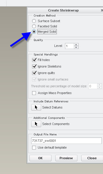

Hello All,
Just wondering how people go about creating simplified models of sub assemblies.
The specific thing I am working on is an assembly with several different bearings. While I want to keep the bearings in the assembly and it is nice they look like bearings when sectioned etc I would like to to simplify them. By simplify I mean ideally turn them into a single part. The bearings currently are as downloaded from the bearing supplier and each one has a dozen different parts. For this project I want to keep everything in a single folder and having lots of bearing parts is making it more difficult to see the other parts. Also I have to email assemblies and it would be better if the bearing was then just one part, instead of several.
I could remodel the, but this seems time consuming and unnecessary.
I also could Shrinkwrap them, but this creates external surfaces only.
Any recommendations would be appreciated.
Thank you.

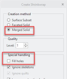

To close this community thread on the ability to Simplify a Assembly into a part.
Summary of the proposed solutions, also detailed in article CS29678 :
  • Convert the assembly to a Solid Shrinkwrap
    • Use the File > Save as > Save a Copy command to save the assembly with the Type Shrinkwrap
    • Then select the Merged Solid option.
    • You can increase the Quality and also uncheck the box to Fill holes if you want to keep some more details.

Shrinkwrap is used to create solid geometry and depending on the quality level you choose, the part can be identical, internally and externally, to the original model. It is definitely the easiest method. If the option isnt' available, there is some problem with the original model such as it contains surface models or has some sort of geometry that can't be converted.
Other options are external merge/inheritance (may be an option not available to all), merge (creates a reference to the original model and a merge part in the original model) and using a step export and re-import with the option to make as a single part (there is an option to do this but it eludes my memory at the moment).

Hello Stephen, thanks for the quick response. Using shrinkwrap it is always fills the internals for me. I am selecting the Merged Solid option already.
I have tried putting the level to 10, and it makes no difference. Unless I unclick all the special handling boxes it justs gives me a single cylinder with rounded edges (So loses all the shield and race details.

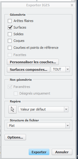

Hello Gavin,
I've already done this because one of my customers was sending me electronic boards assemblies made of hundreds of parts and it was really putting down my computer.
I found a method to convert those assemblies into a single part.
I export the assembly as an iges file using the config shown bellow, then open the iges file as a part. You'll find attached the bearing made in a single part using this method.
