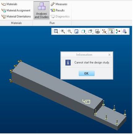

While working with Creo Simulate 2.0, I applied all the constraints to a model and while doing Analysis and Studies i'm facing this issue "Cannot start the design study".
What exactly the issue is??

Double check your assigned material file has Density, Posions, and Youngs Modulas assigned in the material file?
