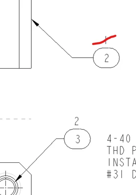

Single Balloon Quantities for repeat region
Hello, We are setting up repeat region BOM tables. Our standard is not to put a "1" on a balloon if the qty is only 1 each. Is there a way not do display a quantity of 1 and still keep the tie to the table?

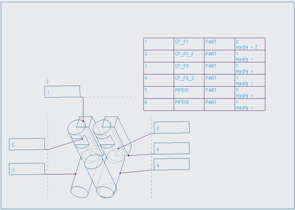

Oct 11, 2022 7:23 AM UTC
1.] you have to define repeat region relation
2.] you have to define&apply BOM custom symbol
3.] example
3.] example
6-Contributor
Oct 11, 2022 3:26 PM UTC
Worked perfect!!! Thank you!!
