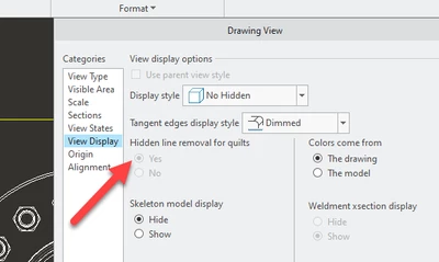

I have a large assembly with a full model of a vehicle as its base. In order to save time and energy I created a skeleton model of the truck assembly with the shrinkwrap tool. I then mate my components to this skeleton to avoid having creo load and render the entire truck each time I open the assembly. Once I begin to display my section views in the drawing the skeleton models hidden edges are shown and cant seem to turn off the hidden edges of the skeleton.

It's specifically section views, correct?
Edit the section  in the model to "include quilts"
Edit the view properties in the drawing for Hidden line removal for quilts (mine is greyed out, yours may or may not be.
