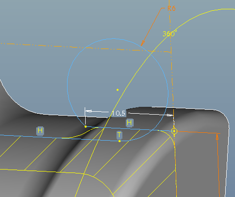

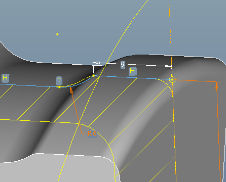

So, I've sketched a revolved cut. (The part is cut into a segment for Mechanica cyclic symmetry.)

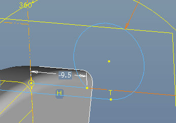

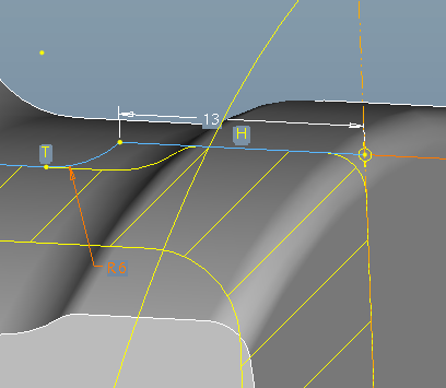

With the length at 9, it works. If I edit the value, it seems to have a random chance of simply stretching the geometry, or turning the arc inside out!
... but then works again at another value.
I've dimensioned plenty of sketches like this over the years, but this one started causing problems doing a Sensitivity Study in Mechanica.
Is this likely to be an accuracy thing, or something else?

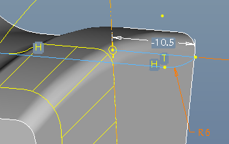

Just for giggles, what happens if you input the 10.5 value as -10.5?
July 11, 2012
Go figure...

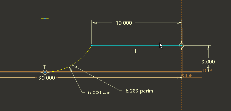

Hi Jonathan...
I've had weird issues with sketches in the past. They're rare but they've happened to me before.
I can't say I know why you're having the problem- but I have a potential solution to fix it. Or... at least "patch" it so you can continue work.
Try changing the arc from being driven by the "R6" radial dimension. Instead, convert that arc to a perimeter dimension using the "R6" as a reference. It would look similar to below (click for a larger image)...
This way, you can lock that perimeter dimension and sketcher can't force the arc to flip. You'll still have the same radius but the arc can't go haywire when you're attempting to use those "middle values" that flip the sketch.
Sorry I don't have a better answer but this might get you through!
Good luck!
-Brian

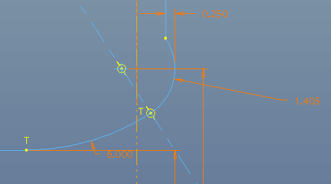

I've seen some weird stuff in sketcher too. I tend to use pretty complex sketches in my top-down design, especially if I'm doing any motion, and I've seen some bizarre stuff. As you saw, usually with arcs flipping. Sometimes what I'll do is simply delete the offending arcs and put them in again, using "replace" if the arc is used elsewhere.
Here's a thought I just had: Try adding a tangent construction line (as shown dotted) or arc to the end that keep flipping, and constrain that. This way the arc cannot flip without breaking a constraint elsewhere.

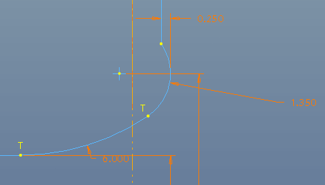

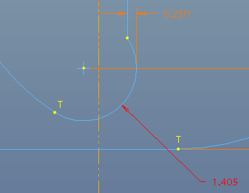

OK, hit the issue again:
But then I tried adding a construction line - not even an additional constraint, just something else for Sketcher to solve - and it cured it!
This software just gets weirder...
July 17, 2012
It would probably also work if you added a dimension to the tangent point of the radius.
