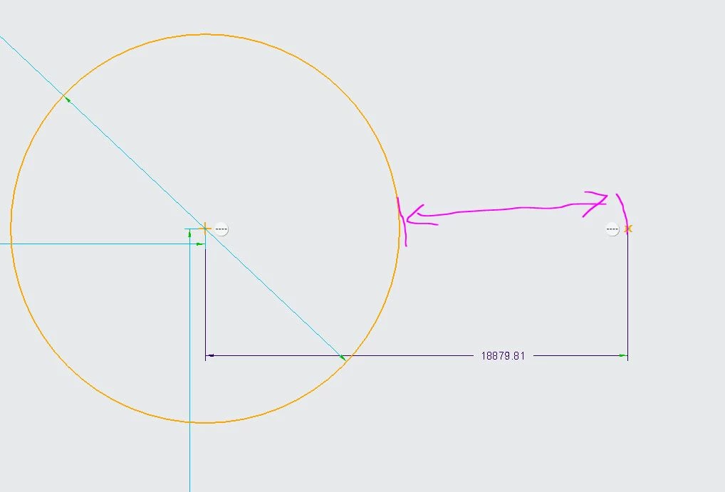

Sketch dimension from point to circle
Hello members, how can I give dimension from Circle boundary to point? Its snapping to circle center point. See attached image. Thanks.

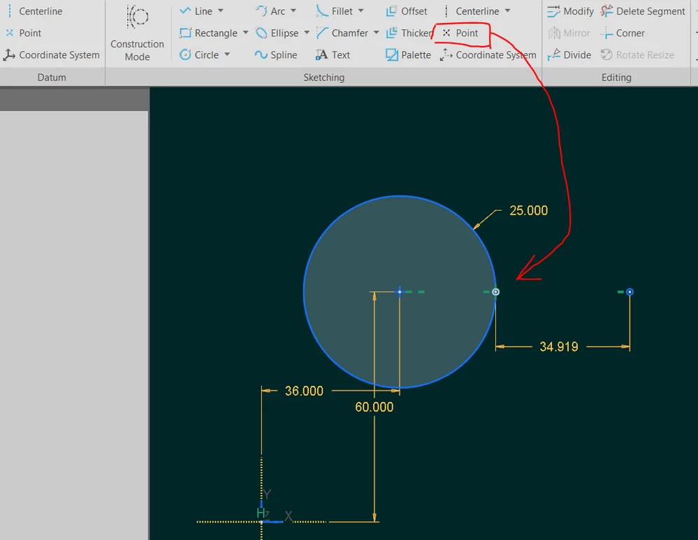

Create a construction point on the circle's boundary, then dimension to it:
pausob19-TanzaniteAnswer
May 14, 2022
kdirth
May 16, 2022
Another option would be to create a construction line from the point to the circle adding a Point on Entity constraint between the line and the center point then dimension the line.
