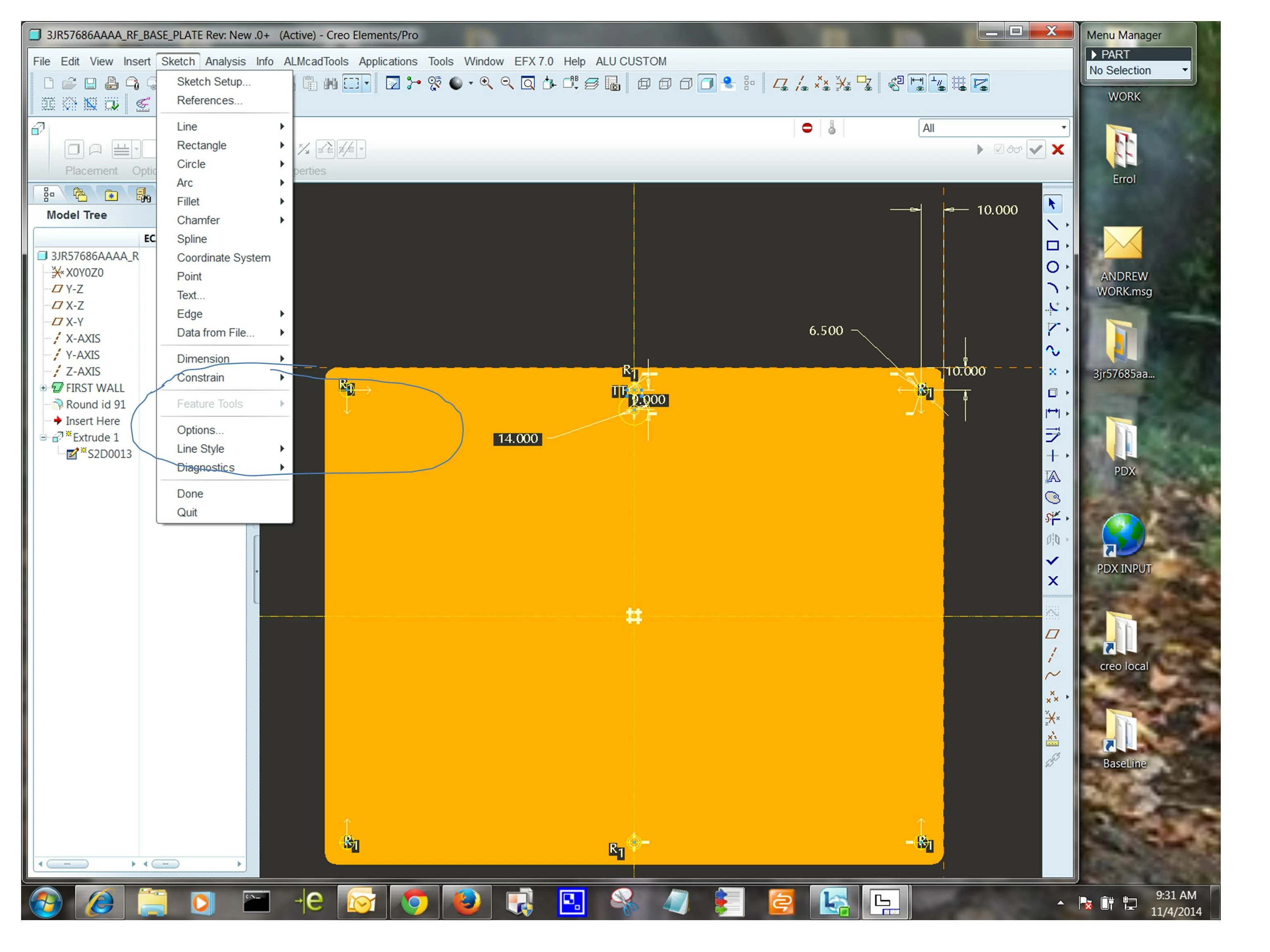

Why is Sketch Feature Tools greyed out in WF5????
15 replies
wfalco16-PearlAuthor
November 4, 2014
see pic - to clarify.
I used to use to make centerlines for slotted holes. axis point?
November 4, 2014
Wayne,
Sketch, Feature Tools is grayed out except for certain commands (Thicken and Blend functions are the most common ones I used to run into) in WF 5 - here's what should be displayed:
[cid:image001.png@01CFF818.F7437310][cid:image007.png@01CFF819.5593E3A0]
Not sure if this helps or not. For the vast majority of features types it was always grayed out

November 4, 2014
In WF5, the old "axis point" is now called a geometry point. I think it's grouped on the toolbar with a regular sketch point.
It will make an axis in an extruded feature and a datum point in a plain sketch.
November 4, 2014
I have ALWAYS uesd for "start point" I think it was called.
November 4, 2014
I was told to do different way and that is also greyed out.

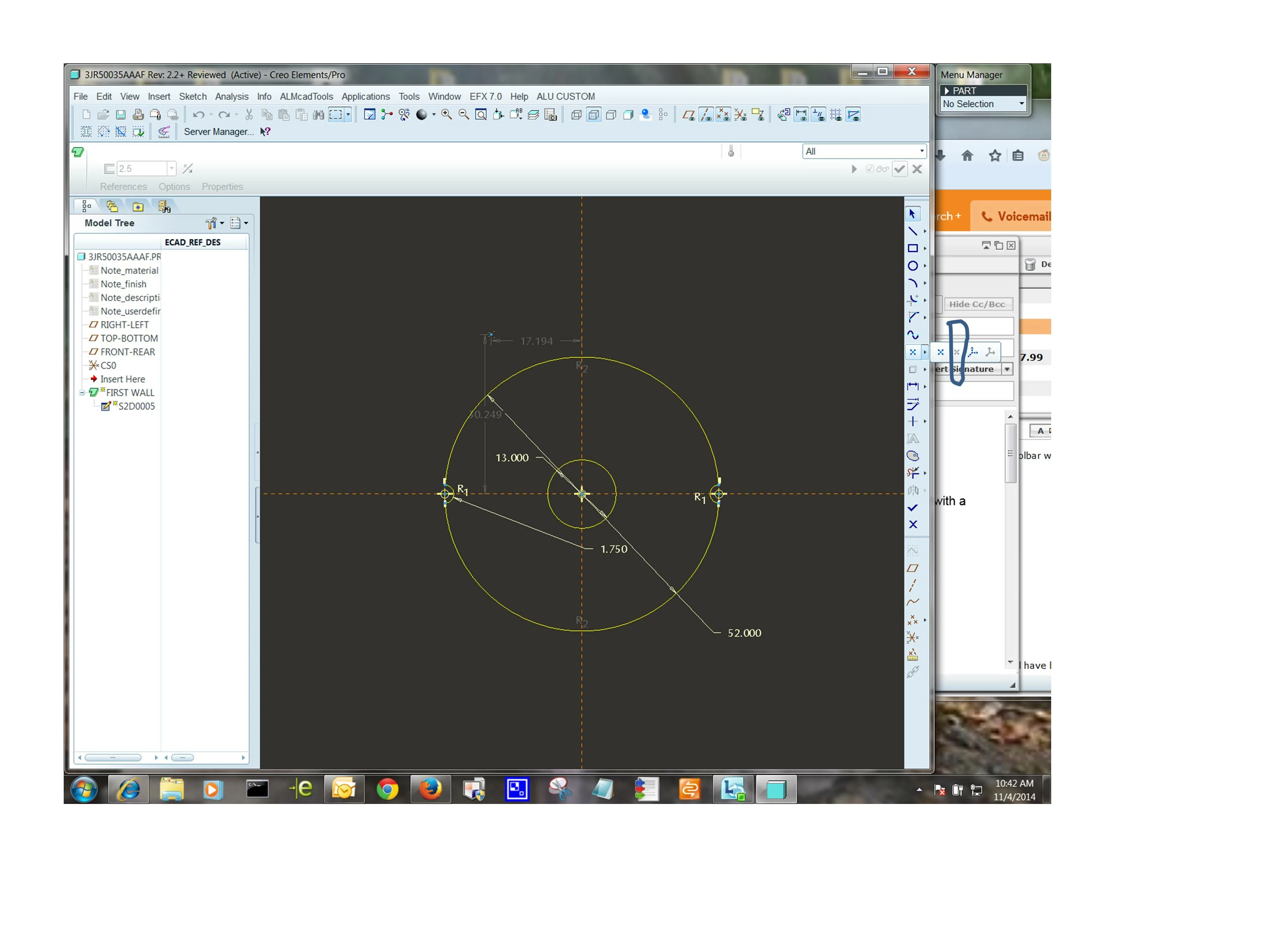

November 4, 2014
The first point symbol makes a point in sketch. I assume the second is
the one I want. Its greyed out. see attached.
November 4, 2014
I got point tool to work on solid and on new sheet metal. I am assuming
that it won't work on older files???
November 4, 2014
I just got this to work on an older file. I'm loosing it at this point
(get it?) I will have to spend some time experimenting. Thanks all!
November 4, 2014
Easy Solution? Maybe you could model the revolved feature as a revolved feature. Then the axis is locked in.
Mike Locascio
November 4, 2014
Yes. In Creo Parametric 2 it looks like a point. There is no other point on the sketch menu - that I am aware of.
