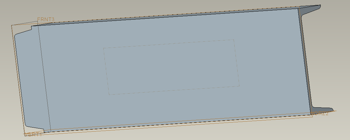

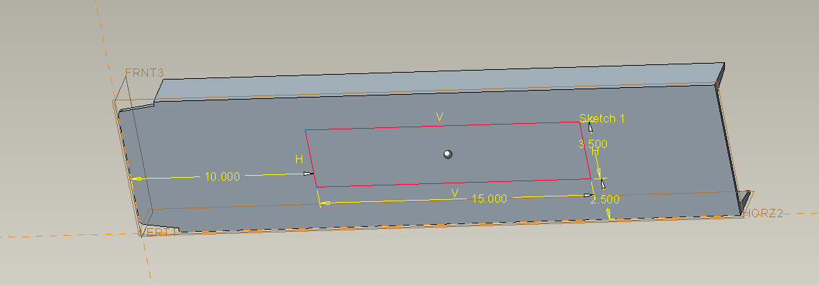

I have a 2d drawing and I want to sketch a small box in a view and dimension it to size and then reference it some of the line features on a view.  8 hours later I gave up  and I still can figure out how to do what would take 5-10 minutes in SWX or Inv.. truly annoying.. need some help

If you are wanting to dimension to scale of the part, it's easiest to just sketch on the part in the model. Use layers to turn off the feature in the model.
Creo drawing is not your friend. Do as little in the drawing as possible and as much in the model as possible.

Set the Grid origin to the point you want the box to be, set the grid X and Y to match the dimensions you want; set Grid Snap On. Sketch a Rectangle/4 lines. Reset the Grid origin and turn the Grid Snap off. It should take about 60 seconds in Creo, but maybe a full 2 minutes if slacking.
Still, it's better if the geometry is to represent something about a model to add it to the model, but since you said 2D, I assume no model involved.
