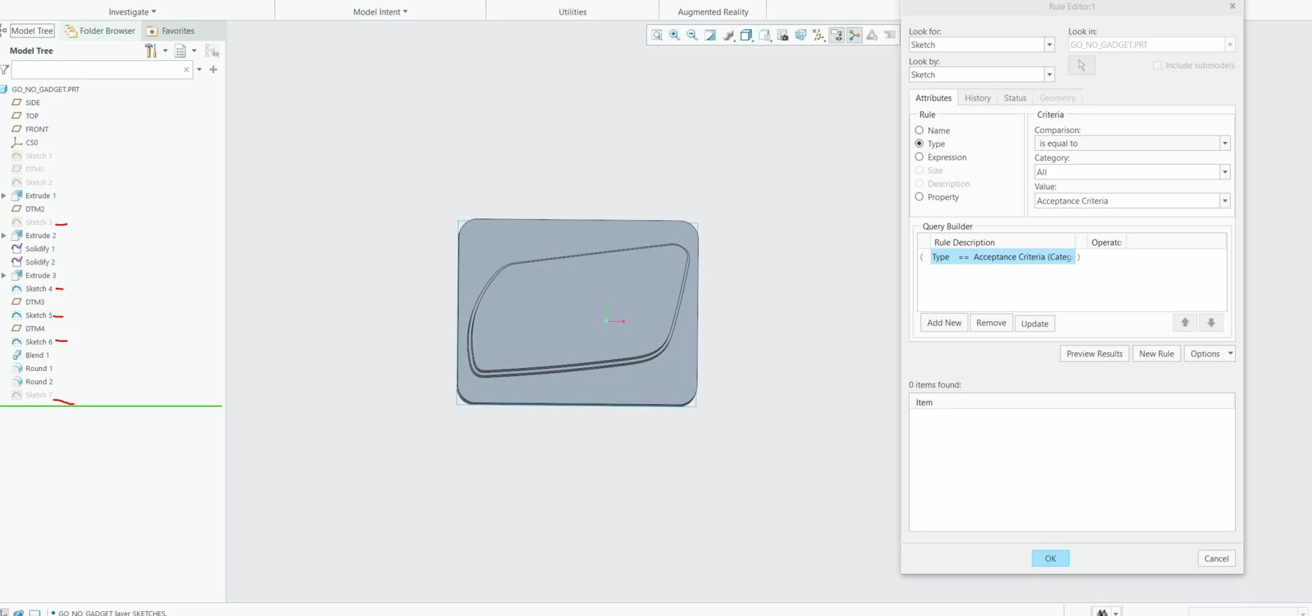

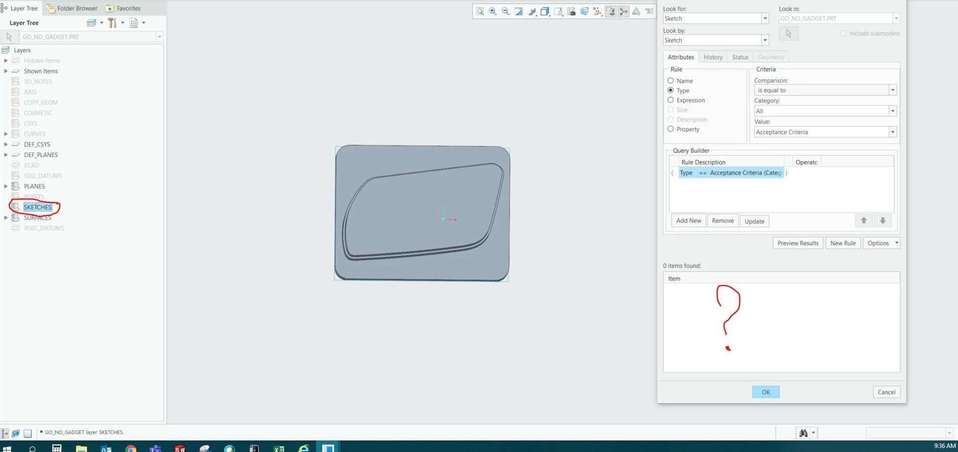

I need help again. I want to make a layer which is ruled based for all sketches. I tried to do it, but nothing is happing. As you can see I have some sketches but they don't get into that layer. Can someone help me with that?

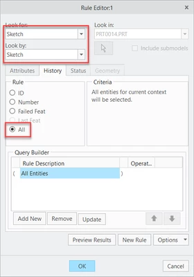

You may try Setting "All" under History, that should help.

Thanks, this was really helpful.
