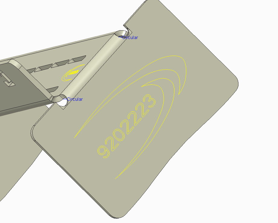

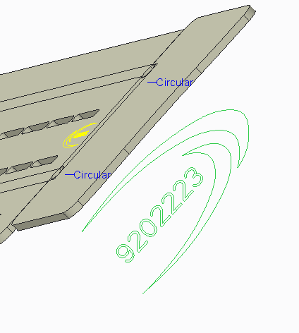

I'm trying to place a sketch on a sheet metal surface. All goes well until I make a flat pattern. Then the sketch is not on the surface anymore but floating on his original positionCapture1.PNGCapture2.PNG
The goal is to have the text and graphics on my drawing. This drawing I send to my supplier and then the text is engraved on the sheet metal by the laser cutting machine.
How can I solve this?

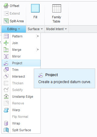

The sketch feature will not follow the surface it is sketched on.  After you create the sketch feature, then select it and go to Editing > Project:
In the Project dashboard, make sure the that Follow Surface option is selected, under References:
This will allow the Project feature (which references the Sketch feature) to follow the surface when unbending or creating a flat.
