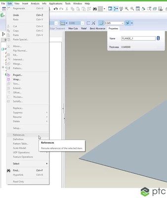

In past versions of Creo (Pro/E)  (Creo 1 e.g.), I could access this menu and rotate my sketch, by selecting a different plane for the secondary reference.
I wish I could just rotate my sketching plane in 90 degree increments til I have the orientation that I want (consistent with the design intent or orientation of the part.)
Jun 28, 2022 3:22 PM UTC
Hi after firing Wildfire 4.0 i was unable to access the Edit > References menu:
Is there something you did differently?
