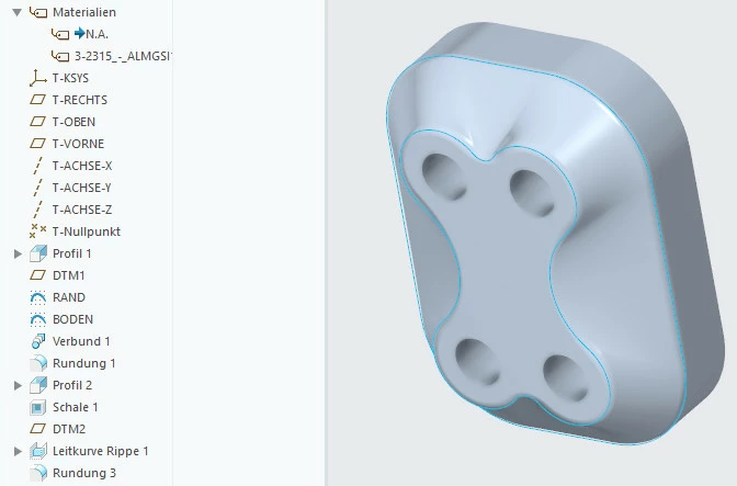

Hello community,
I just made a simple form and saw that two sketches are still visible which normally shouldn´t be visible.
I can hide them manually but I wondered why they are shown now (like said, normally they are hidden automatically)
I made a composition between the sketch "RAND" and "BODEN". Boden is the inner sketch and rand is the outer sketch. I have enabled the material for better visualization. Attached you can find a photo.
Maybe someone can help me to adjust this error.
Thanks in advance.

    you can select both sketches and apply Hide command. Then you have to switch to Layer tree, click right mouse button and use Save status command. At the end you have to save model.
    Also you can put both sketches into some layer, hide the layer and use Save status command + save model.

    You have a Swept Blend using external sketches.  External sketches are not automatically hidden when you make a Swept Blend, internal sketches are.
    As @MartinHanak wrote you need to add the external sketches to a layer to keep them hidden.
