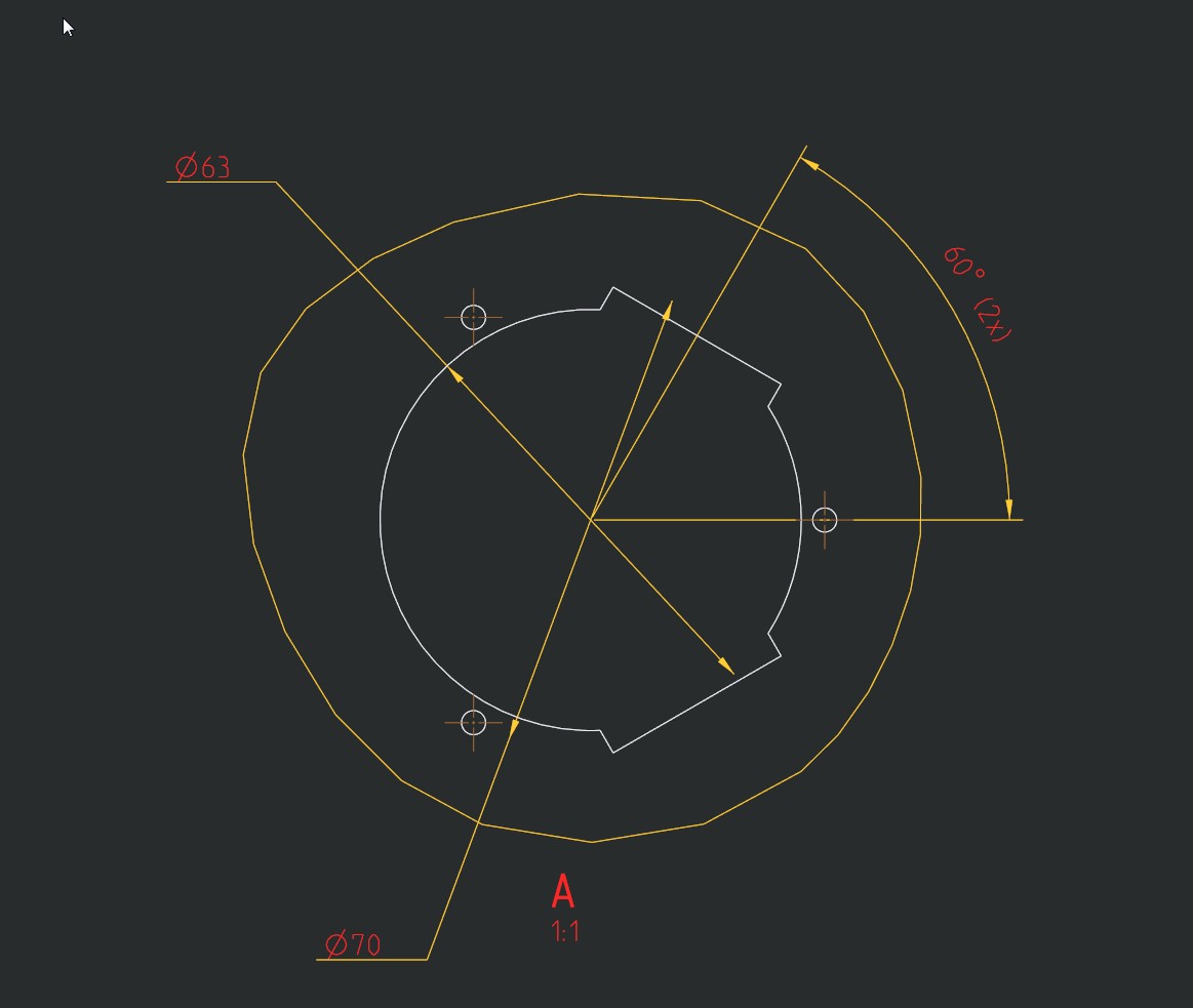

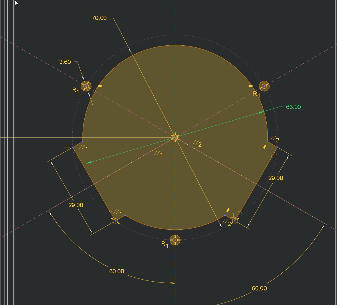

April 28, 2014
Generaly:
1) Drawing SHOWS information from MODEL ---> all information must be included in model.
2) Make some adding sketches in drawing is WAY TO HELL.
See attached pictures:
Model space:
Drawing space:
"CALL" dimmensions/axes from model.

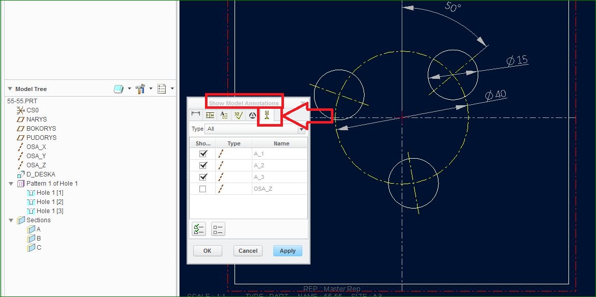

In your drawing options you need to set the radial_pattern_axis_circle option to yes.
To open the drawing options in Creo 2 selec File / Prepare / Drawing Properties. Then on the "Drawing Properties" dialog box select "Change" on the Detail Options line.

April 28, 2014
For your paticular request, you want to change the hole axis to show the bolt circle axis.
Then you can extend the two you are concerned with through the 29.0 features.
Set this in your detail.dtl file (drawing options, not config.pro)
radial_pattern_axis_circle YES
You will have to pattern the hole features to make this work for you.
