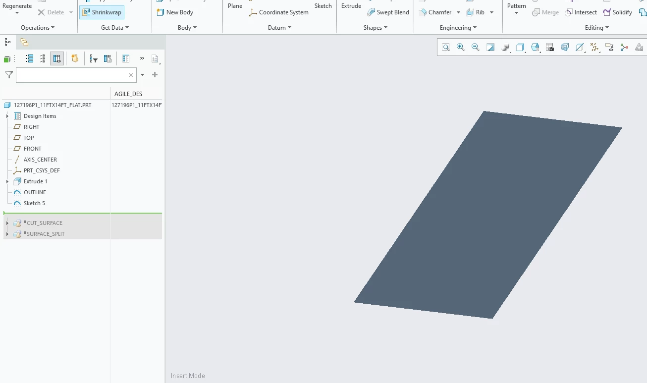

Sketch wont display even when not hidden
These sketch lines are only displayed when they are clicked on in the feature tree.  How can I get them to display in the model so that they can be used as reference geometry?

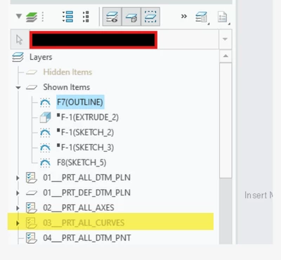

Sep 18, 2024 5:49 PM UTC
You have a hidden layer for all curves, unhide it and report back.

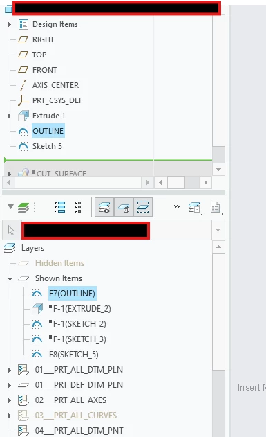

Sep 18, 2024 5:36 PM UTC
First try displaying the model in wireframe with no hidden lines. If they are still not visible, then use feature info to find out if they are on a layer that is hidden.
Without access to the data, it is speculative to suggest the root cause of the issue.
6-Contributor
Sep 18, 2024 5:37 PM UTC
They do not display when in wireframe, and they are on the "Shown" layer
