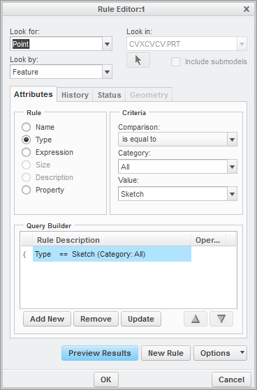

I'm struggling with managing my sketched points with layers.  My rule based layers did a great job unitl sketched points were moved into the general sketch feature.  It's a welcome change generally, but it has made managing the visibility of points more difficult.
All my sketch features are placed on a 00_CURVE layer including sketches that have no curve entities, only points.  Those sketch features don't end up on  my 00_POINT layer either, however.  There is no option for "has_points" as there is for has_axes".
Has anyone found away to get sketch features with points onto a specific layer and a way to keep sketch features with no curve entities off of the curve layer?

I'm a little confused Doug.  Do you want curves with GEOMETRY (not construction) points on a specific layer, say, "POINTS" (but no other layer, not even "CURVES"), but curves without geometry points on a layer, say, "CURVES"?
November 11, 2016
Yes, I'm talking about geometry points in sketches, not construction points.
First and foremost I'd like to get sketches with geometry points on my points layer.  Right now there's no way to capture sketches with geometry points (or coordinate systems either, for that matter.).
Beyond that, I'd love to prevent sketches that are entirely points with no curve geometry from going on the curve layer.

Actually, I think I found exactly what you're looking for Doug.  I think Raphael is close, but if I understand you, I think this will work better:PUT ONLY GEOMETRY POINTS IN CURVES ON A LAYER-01.bmp
This puts ONLY the GEOMETRY points in a datum curve on a layer, not points generated as stand alone points, and does NOT put the curve itself on that layer (in my case, layer:  01_HAS_POINTS).  I'm sure you could also do this for CS's, and you could also probably separate to have ONLY geometry in curves on the curve layer, not the GEOMETRY points or GEOMETRY CS's as well.
Hope this helps!

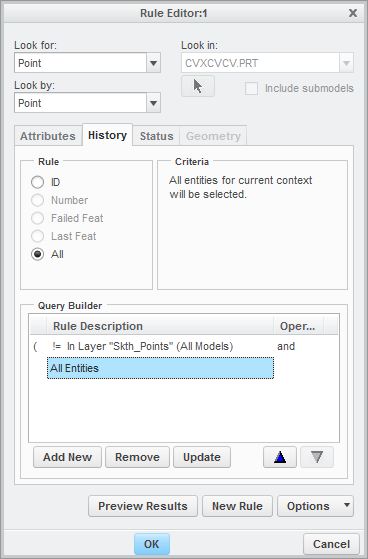

January 3, 2017
Iam not sure why there is a problem for you. I was able to achieve what is being discussed here (if I understood correctly).
I was able to create layers for curves, datum points and sketched points, all with rules and was able to hide all of these independently without overlap.
Iam using Creo 2.0 M180. see attached snapshots for Datum points and Sketched points.
Let me know if I have missing something form the discussion.
Manjunath
Chris3
January 3, 2017
Whats your rule for curves? This is the tricky one because it would need to hide any splines that are part of the curve feature but not the sketched points.
