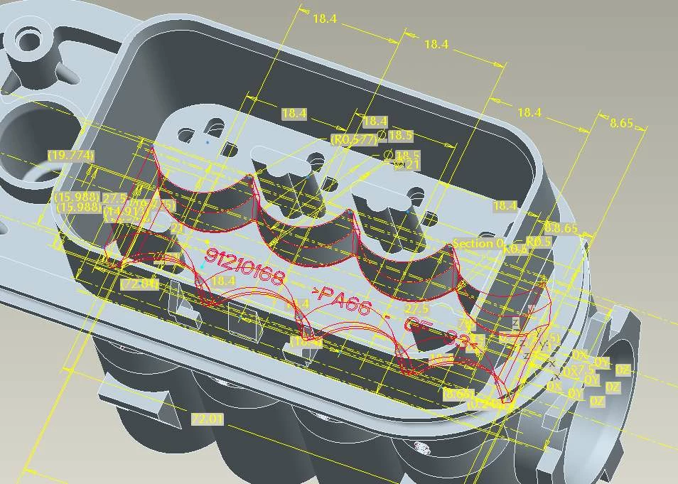

I don't do it very often but once in awhile intent manager just will not accept my sketch and dimensioning scheme. I am usually able to get the same geometry, constraints and dimensions to regen with the intent manager turned off. So please, never remove the ability to turn off the intent manager.
The attached pic is one blend feature that required intent manager to be turned off. Note that the screen shot is just picking the feature and selecting modify. It is a blend feature with 4 cross sections so you are actually looking at the dimensions for all 4 sections at once. I had to turn intent manager off for each each section even though section 2 is exactly the same as section 1 and section 4 is exactly the same as section 3. I did a save & retrieve for the repeat sections.
