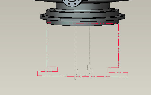

January 28, 2016
I am in a similar position.  We are using in the process of going from Kubotek KeyCreator 11.5 to Creo Parametric 3.0.  With some drawings, I have been asked to create a boundary x feet from a pit. I first tried to draw it using the sketch command in the final drawing mode.  Lines could be created, but no obvious way to dimension them.  I am used to the AutoCAD and Inventor products and there are multiple ways to accomplish this.  Thoughts on this?
StephenW
January 28, 2016
I'm assuming you have a drawing of a model...
Add a sketch feature inside of your model showing the boundary. The sketch will be dimensionally accurate.
Use layers to control the display of the sketch on the model and drawings so you only see the sketch where you want to see it.
The image below is actually 2 sketches (one on each plane) of an interface component that I need to show on a drawing but I have no other purpose for it (no manufacturing).
