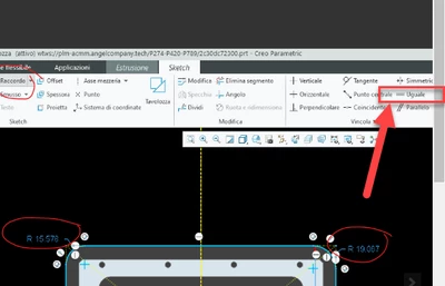

Sketching with same fillet radius
is there a manner to drawing same fillet radiuses while sketching, without use relations between dimensions?
Best regards
Michele Barile
mkajdan
mkajdanAnswer
Mar 1, 2023 1:55 PM UTC
You can also use the rounded rectangle shape in the Shapes tab in the sketcher palette.
StephenW
Mar 1, 2023 1:49 PM UTC
use the Equal constraint.
mkajdan
mkajdan14-AlexandriteAnswer
