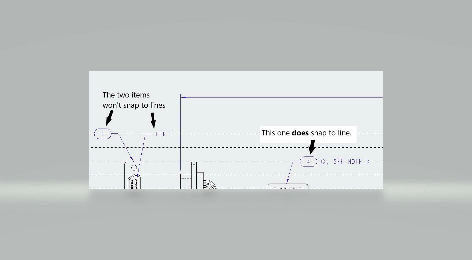

Has anyone ever ran into an issue with not being able to snap objects to snaplines in your drawing?
I've got a case where some of my notes and balloons will snap and others don't.
Perhaps it's a glitch or bug.
I attached a screenshot for clarity.
-Cory

The note/dim/sym/etc. needs to be assigned to the view in which the offset lines are assigned.
It appears you have multiple views with one set of offset lines.  Symbol "4" is on the view snap lines are created, the others are on a different view and will not connect to the same offset lines,

Thanks kdirth! That did the job. I didn't think about the Snap-Line relationships to the views.
