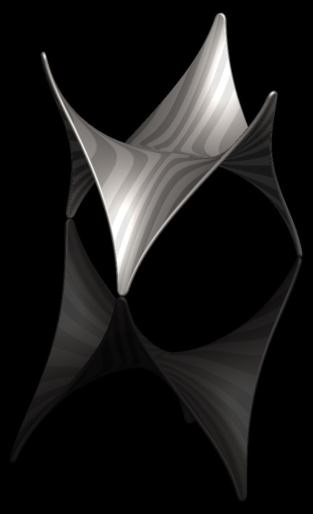

I found an interesting discussion in the SW forum:
https://forum.solidworks.com/thread/102012
Before I found the SW model, I modeled it in Pro/E and added rounds that I wanted to make the ends nicer (i.e. flat plane thru 3 points).  When I got the SW model, I exported a STEP into Pro/E and was pleasantly surprised at how good the "loft" was when doing a reflection analysis on it.  It almost perfectly matched the Pro/E model.  I think Pro/E has better boundary blend controls (tangent, control points, curvature continuous, etc.), and the round command has quite a few more options (SW does not have "sets" in the round command, or all the options on shape - variations of C2 round, etc.), or end transitions.  Anyways, it taught me a lot about how to work in SW, which was the main goal of me looking at the forum.  Here it is in Pro/E (of course).  Note I could have taken a feature or 2 out of it, but wanted to merge first because I thought it would give me a better overall surface.  I'll have to check that later.:
November 11, 2015
As an ID guy by training, your model and the SW model posted both don't quite capture the design in the photo.  In the photo, the edges of the legs appear to be a single concave arc or spline, both models appear to have more of an S curve shape to them.
I haven't looked at either file to see how or if that changes how it'd be made.
Fun shape nonetheless.
Patriot_1776
November 11, 2015
True, but I simply copied the dimensions and overall scheme from the SW model someone on the SW forum made, so I could compare apples-to-apples on the construction method and result.  Then I just had to add a tweak of my own (the additional tip rounds (because it looked cooler and always gives a 3-point plane).  Without having the actual dimensions of the table and the type of surface curvature, neither the SW guys or us could 100% reproduce it.  For instance, I can tell it's not 9" high, and .2 thick like the SW model.
