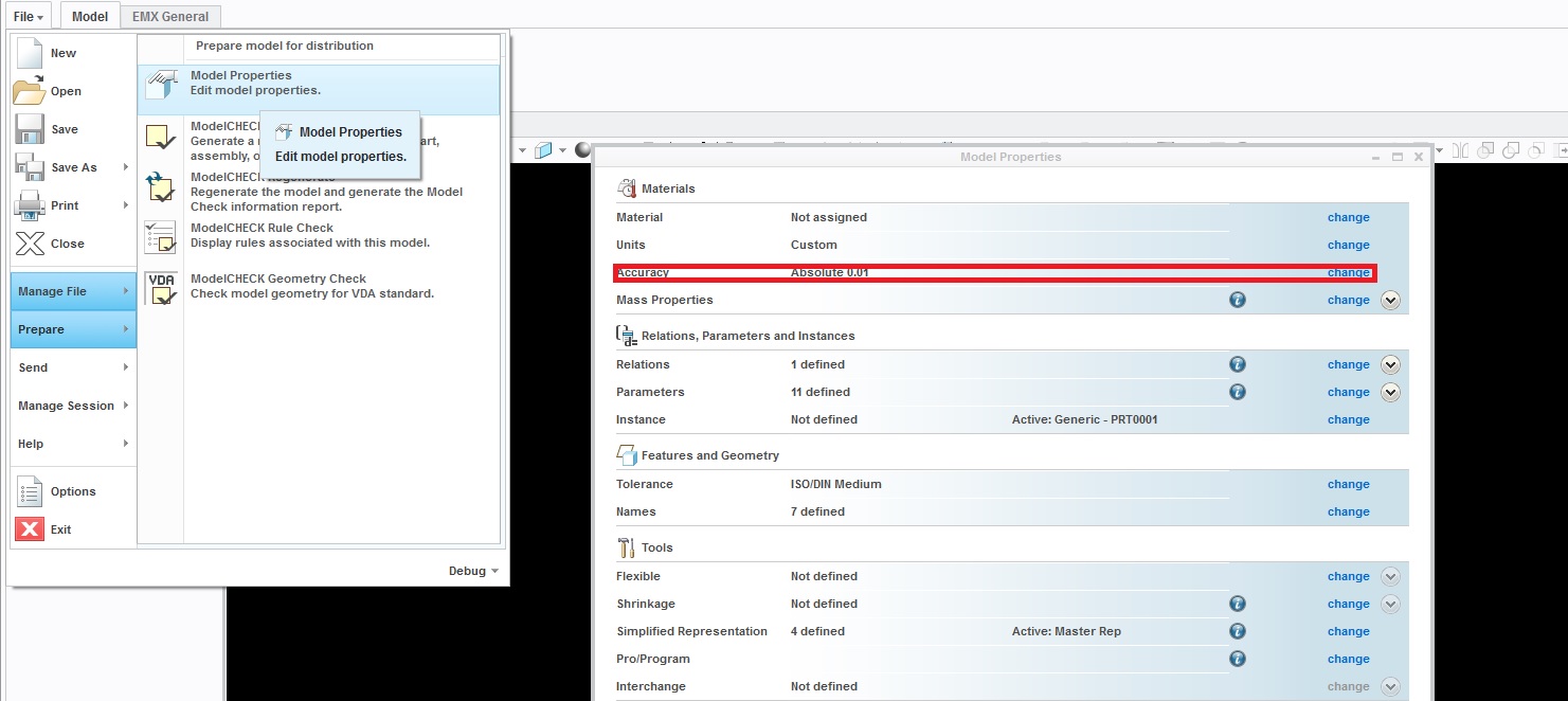

I'm working with Creo 3.0. I'm drawing molds for a client. My client tells me that the delivered files are not solid but I see them solid. He tells me that their CAM system needs solid models with 0.01mm tolerance. How do I set this tolerance? for single parts ? for assembly or just for exporting ?

I don't think I agree with this. Accuracy is not the same as tolerance.
October 19, 2016
I think so
October 19, 2016
Thanks Pepa Nos, but I do not find the absolute accuracy option. I had to activate  the variable "enable_absolute_accuracy" on yes.
October 19, 2016
Perhaps I helped
