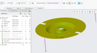

Another option is the following
  1. Create a new part (sheetmetal)
  2. use Copy Geom to bring in a surface/quilt
  3. Create Offset Wall type (Model > Editing > Offset)
    • Offset =0
    • Select direction to set thickness
    • Set wall thickness

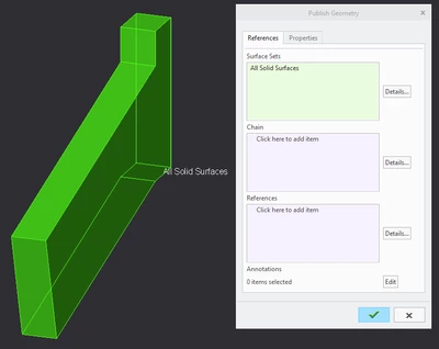

I have tried your method, but I am using the "All Solid Surfaces" with my Publish Geometry, and I can't create the Offset Wall Type in my part. There are some extremely great advantages for me to use the All Solid Surfaces option, I can't publish just one surface (to give you some more information, I am (un)supressing completely different geometry within my Publish Geometry part).

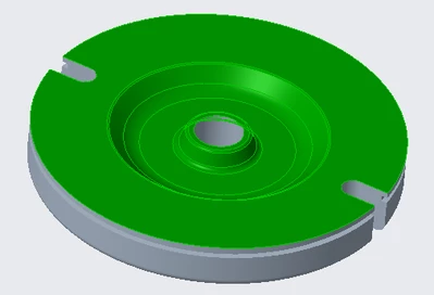

Hi, the steps I gave as an option are under the assumption you are bringing in a surface quilt that has no thickness.  For example, if you had a complex contour and you bring in only one side of surfaces. See below
Solid part looks like this, green highlighted surfaces is what I select with the Copy Geom.
I only selected certain surfaces (on one side) of the part so it is a zero volume quilt I am starting off with in the sheetmetal part

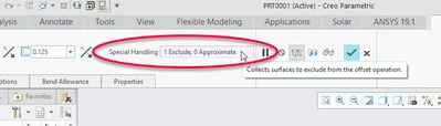

Alternately, if you do bring in all solid surfaces, you should be able to use the Special Handling area to remove surfaces that are considered for the Offset operation.
