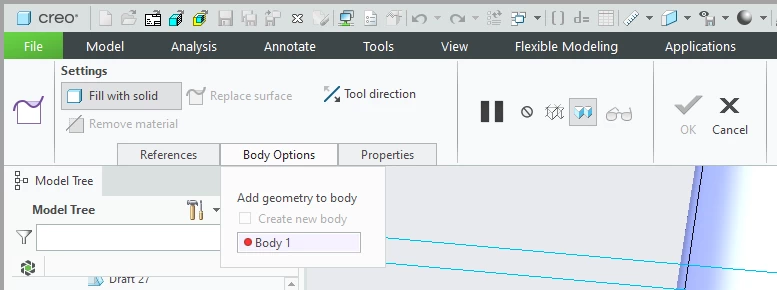

Solidify Features Fail on Existing Models When Opened in Creo 7.0
We're in the process of upgrading to Creo 7 from Creo 4, and when I open many of our models created in Creo 4, the Solidify features all fail.  It appears to be struggling to assign the new solid to a body.
If I create a dummy solid prior to the first Solidify, then I am able to access the "Body Options" tab in the Solidify tool and get it to work.  However, the Solidify features below it all still fail.
Is there a config setting I'm missing, or a way to disable the Multi-Body feature on legacy models created in prior versions?

Jake_1175-Regular MemberAuthor
Oct 29, 2021 2:14 PM UTC
Update: This is where I'm getting stuck again.  The solidify command won't solidify to Body 1.
I'm worried this might be just poor modeling because a prior solid was converted back into a quilt and then is attempting to resolidify.  I'm new to using Bodies; does this confuse what Creo thinks Body 1 is?
This solidify also acts up in Creo 4 sometimes, but I'm usually able to regenerate and resolve it.  So that's why I'm inclined to believe it's getting hung up on the new Multibody functionality.
Mahesh_Sharma
22-Sapphire I
Nov 9, 2021 6:18 PM UTC
@Jake_117
If it is only solidify and if feature is getting solidified Body should work. But without looking the data, it may difficult. Do you have any sample file to share for a review?
