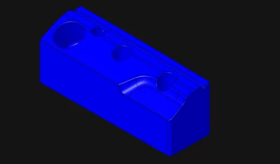

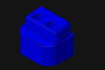

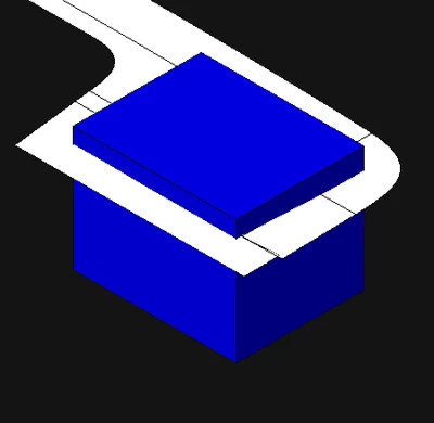

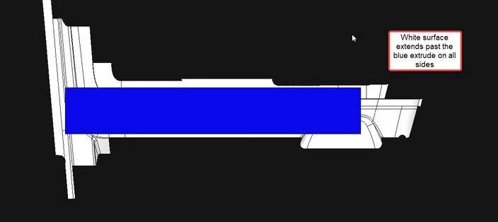

    In Creo if you want to cut to a surface, the surface that you're cutting to needs to extend past the geometry that you're cutting. There are a bunch of ways to accomplish this. I prefer to use the extend command in data doctor to ensure that my surface extends past my geometry.
    See the examples below:
