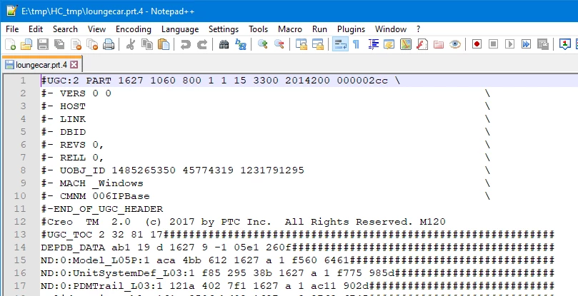

As requested, here is one of the files in Zip. It is the lounge car of a train we were asked to do.
I also put the STL so you can see what it should look like.
Feb 26, 2024 1:51 PM UTC
I can open loungecar.stl in Creo 6.0.5.1,
All four versions of loungecar.prt were saved in Creo 2.0 M120.
You can add following option at the end of config.pro to eliminate graphic card driver problem. Do not forget to restart Creo.
graphics  win32_gdi
