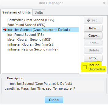

Last question, we also started noticing assembly files that we get from customers, their parts seem to have different units. We usually operate in Millimeters, but noticed some parts may have been set to inches or sometimes Centimeters. Is there a setting to set all parts/assembly files in the structure to one unit?

You can convert the units once you bring them in but you would do them basically one at a time, there is no conversion setting.
file - prepare - model properties - units - change
