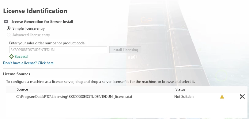

I am using CREO 12.4.0.0 , In the interface of CREO Installation Assistant , After following all the instructions and adding the simple license "BK800908EDSTUDENTEDUNI" and the id password the source is added and its status shows Not Suitable. what to do ?

BK800908EDSTUDENTEDUNI product code belongs to Creo 8.0. You cannot use this code to get Creo 12.0 license.
Please read following documents.
https://apps.ptc.com/schools/references/install_creo_university_edition.pdf
https://apps.ptc.com/schools/references/install_creo_schools_standard.pdf
